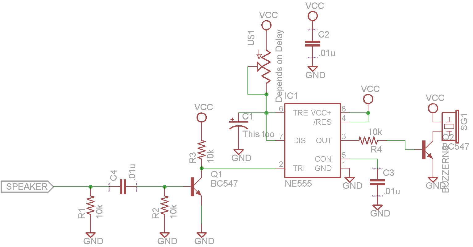

I would like to know how to Trigger the one shot timer by using a 555, from the moment clock radio goes on. I will have to connect the 555 to the little speaker. The 555 circuit is simple, but how do I interface Pin2 of 555 to speaker??

Measure the voltage level from the Speaker, then use a small signal transistor like BC 547 to trigger the 555
may be like this
