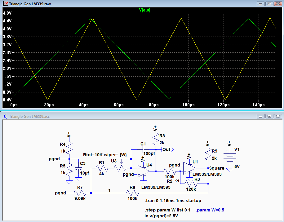

Below is the LTspice simulation of a triangle-wave generator that uses an LM339/393 comparator package to perform both the integrator and the comparator function.
That avoids having to using a high frequency op amp to get sharp corners on the triangle wave and a fast rise-time on the square-wave output..

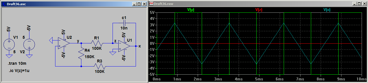

Try using an "initial condition" on one of the feedback nodes to displace it from the initial voltage found by the "DC bias solution" of the Spice simulator before it begins the time-based part of the simulation. Often, with oscillators, you have to introduce a bit of "noise" into the feed back loop of an oscillator to get it to start. Noise is present in real circuits; Spice is noiseless unless told otherwise.

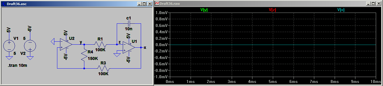

For example: Here is the oscillator. If I just "simulate" it, then all you get is flat lines = 0V for V(x), V(y), and V(z): (that is a stable condition found by the DC bias solution before the transient simulation begins; it is like a perfectly balanced child's teeter-totter. Google "metastability")
If I introduce even 1uV of "noise" at node V(z) by using the Spice directive .IC V(z)=1u, then the oscillator starts, and you get the expected waveforms... (that is like displacing the child's teeter-toter just a bit, and it over-centers and one end touches the ground)
Also note that (my) R4 must be > R3 for it to oscillate.
It is just sitting there in that balanced state where there is a bit of numerical "noise", but not enough to start the "oscillation". I see no evidence that you followed my advice and forced one of the nodes in the feedback path to a starting value away from what your simulation shows now.
That is easy to do in LTSpice using the .IC directive. You will have to find out how to do this in ORCAD.

Add a pulse voltage source between U2A pin 2 and ground.
Set it to output one 0-1mv, 1ms pulse at the start of the simulation.

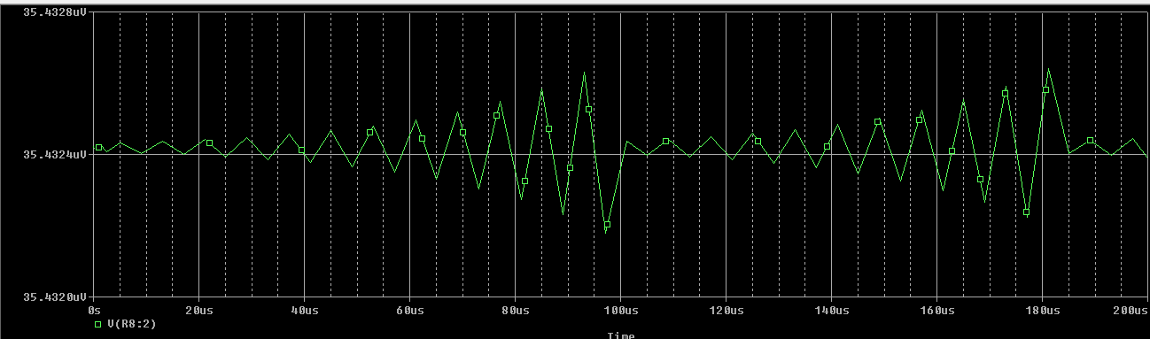

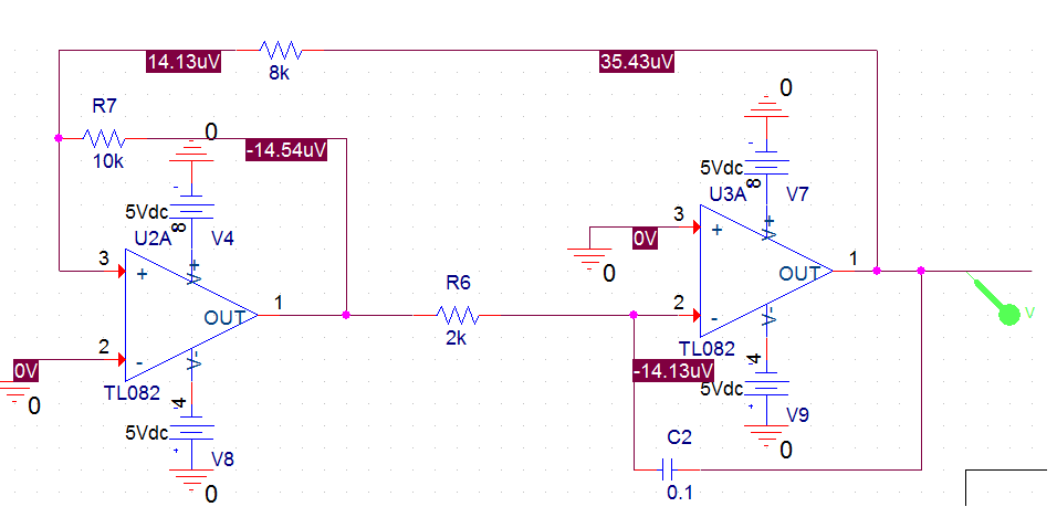

Did you intend C2 to be 0.1 FARADs ? That makes the R6C2 time constant 200 seconds, but your sim is running for only 200uS :rolleyes:.
Good catch; likely won't fix the meta-stability problem though. You can see that his plot is periodic, returning back to zero. If it was going to take off toward oscillation, then the node he plotted would have been monotonic away from the initial value.

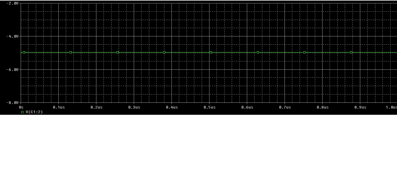

Did you mean this?
You fixed the capacitor value, but as I predicted, it is still not oscillating. Looks like you did not "Read The Flipping Manual" to determine how to add the .Initial Conditions directive as I asked you to...

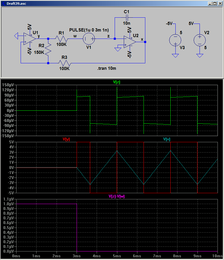

Here is a way to accomplish the start-up by including a pulse voltage source V1 in the feedback loop. Note that for the first 3ms, the pulsed source V1 makes a voltage of 1uV, and then at 3ms, it turns off to 0V thereafter; (see V(z)-V(w) in the lower plot pane). The little -1uV step at 3ms is enough to "kick" the oscillator into starting. Note that V(z), V(y), and V(x) are flat-line prior to 3ms, and show the oscillator behavior after 3ms.
It is the dv/dt of V1 that begins the oscillation. A real circuit would easily have 1uV of noise at V(z) due to thermal effects, but the simulated circuit doesn't, so we have to add it artificially.
