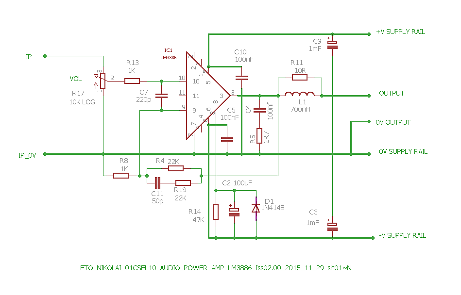

wow, why the circuit look not "well", I mean the ground too funny. Can you tell my what small transistor will use?
:p 'Circuit look not well' because that is how you must wire it, especially in class AB, not so critical in class A but still very important. If you want to know why just ask, but I think you must be getting a bit tired of all the theory. :sorry:
The wiring is vital for two reasons:
(1) Minimise distortion
(2) Minimise chance of oscillation

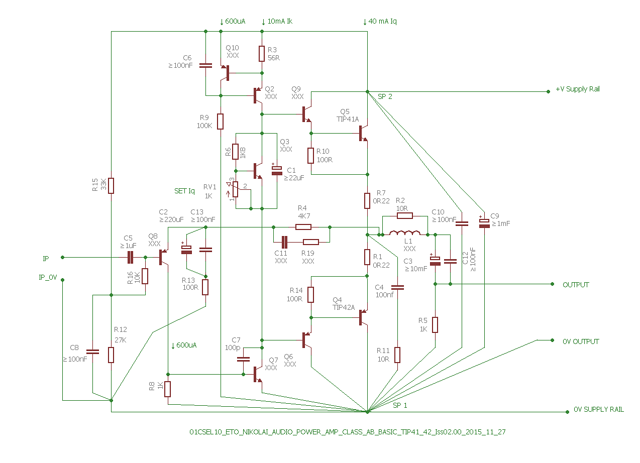

There are three different families of transistors: darlington drivers, voltage amplification stage, and the rest.
I will choose some transistors, hopefully from your preferred supplier.

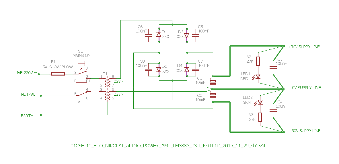

Thank a lot because you spend a lot of time to help me. How many watts of this circuit?
I am learning Eagle circuit capture, so it is good practice. It's also good for me to brush up on audio amps.
TIP41/TIP42 Amp
Power with TIP41A/TIP42A & 60V total supply= 40W
Power with TIP41B or C/TIP 42B or C & 70V total supply= 50W
LM3886 Amp
+- 30V supplies= 40W
+- 35V supplies= 50W

The parallel resistor/inductor combination right before the speaker is called a Zobel Network.
The inductor is "made" by usually wrapping an insulated solid wire, usually about 18 AWG around a 2 to 5 Watt Carbon composition resistor. Carbon is important in this case.
Keep, I think you meant the R and C to ground. The inductor is there to decrease the load the the amp sees at high frequencies and the 10R resistor damps the inductor to prevent ringing. In the audio band, the inductor is effectively just a piece of wire. With the LM3855 you can leave the inductor, damping resistor, the cap on the inputs and the 50p cap and resistor in the feedback network out. In fact many circuits on the net do just that. There have also been some posts on the net about frequency instability with the LM3855-probably why. The belt and braces approach is always best in the end.

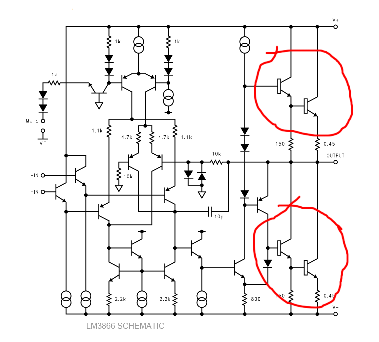

Strangely, the LM3886 does not have a symmetrical output stage which is surprising. The rest of the chip looks nice though- perhaps National could't fabricate PNP power trans on the chip.
