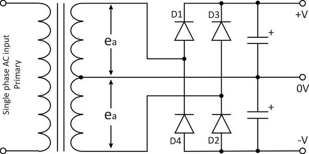

If they need dual positive AND negative supplies - which is common for many analog and audio circuits - you need a different rectifier configuration and transformer setup.
eg. This would work for something like you describe, using a dual 30V secondary or a centre tapped 30-0-30 secondary transformer:
main-qimg-59ca9914bb99cbd0e6ffaac88c12e751
The diodes could be separate or a bridge rectifier module.
It's like two, two-diode centre tap full wave rectifiers back to back, giving opposite polarities from the same transformer windings:

A 30-0-30 transformer should give around positive and negative 41V using the rec circuit above.
Under full load.
If it's regulation was poor, 20% or more, the off-load voltage could be around 50V
And, if you use a "230V" primary transformer on UK mains which is still actually 240V, the secondary voltages will be increased that few percent further as well.
A lot of the time it's not critical - but if the output voltage from a transformer/rectifier combination could be anywhere near the voltage limits for any component, it's worth a bit of extra thought and care.

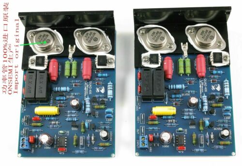

These are the power amplifiers. Cheap ones until I have a better idea about this.

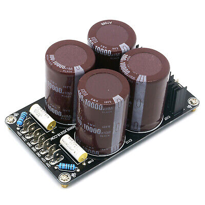

This is typical if the various power supply boards available.

Interesting, but I suggest you read this, especially the second half; those are clones of clones by the look of it.

The amplifier modules are very expensive for a Chinese copy of a 48 to 50 years old design.

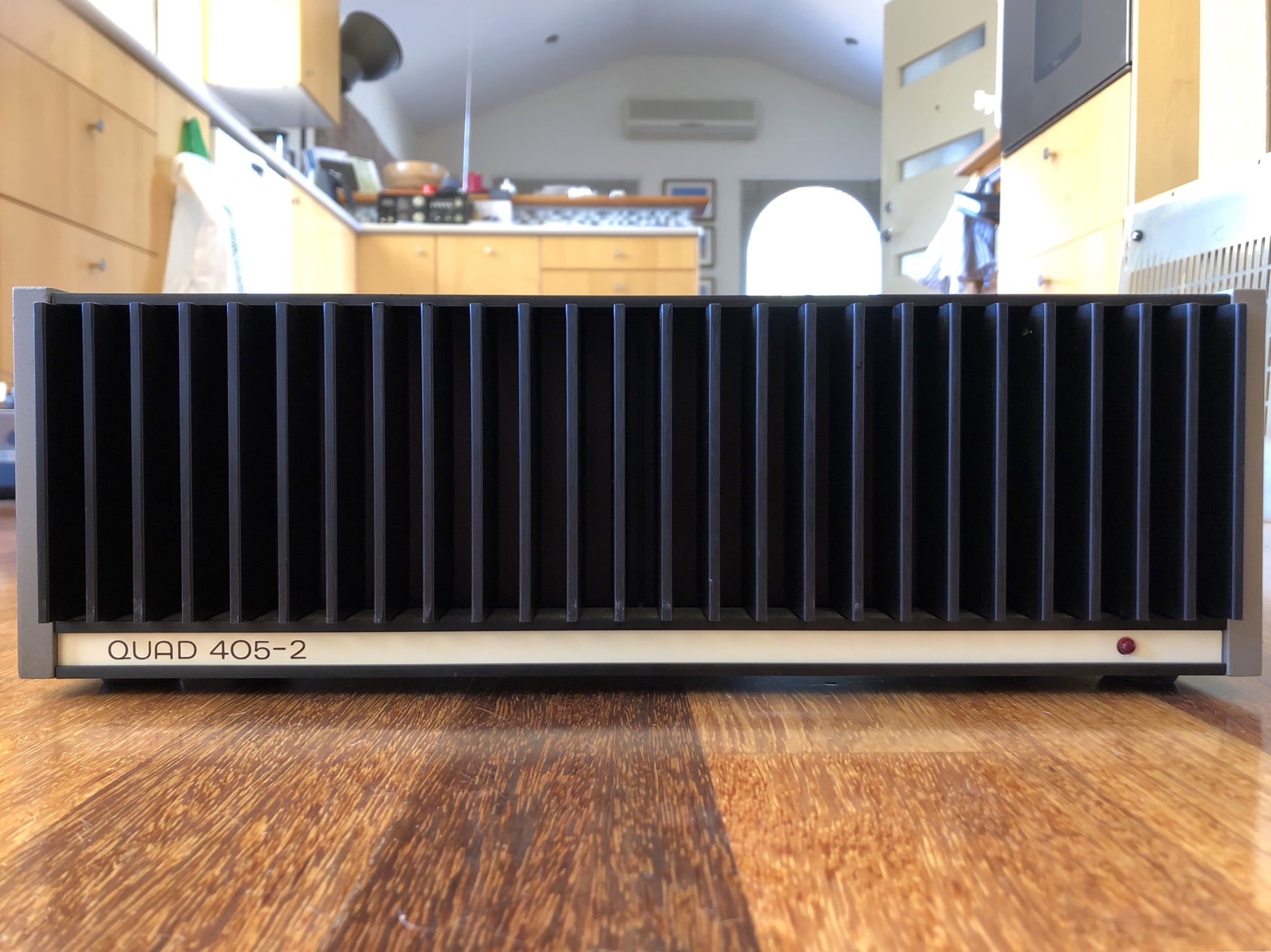

The modules will severely over-heat since they are designed to be mounted on the huge heatsink in the original Quad 405 amplifier.
The design is class-A that makes a lot of heat.
Reviews of this old amplifier are mixed, some like it and others don't. They say the updated Quad 405-2 is much better.

The heat won't be an issue as I plan to attach two stonking great big heat sinks. I've use cooling fans with enclosed valve amps quite successfully so this is always an option.
A transformer with two 15VAC secondaries can produce rectified and filtered plus and minus 20.2VDC. Then the "100W" amplifier that needs a minimum of plus and minus 30VDC will not work.
