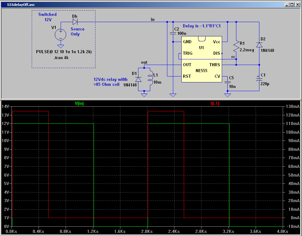

Need help on a timer circuit design. I'm an idiot at IC design. But, I can solder.
I need a timer that does this-
When DC 12V power is applied to Input 1 it starts a timer (timer needs to be variable from 1 to 10 minutes) during this time DC 12V is outputted on Output 1. When timer completes no voltage output on Output 1.
Note- Power will continue to be applied to Input 1 after the timer completes.
Application -> when water flows through a Magnetic Water Flow Switch the circuit is closed that switch & voltage from a battery is connected to Input 1. When waters starts flowing through the pipe I want the timer to start which applies voltage to a flow control valve which opens a valve.
Whats happening is water is flowing into a water storage area which gets dirty very frequently. There is a drain on the bottom of the water storage container. So water starts going into the water storage area the drain valve opens and basically clears out the dirt. After a few minutes the storage area is clean the drain valve closes and water continues to flow until it's full.
If someone can help me with the design or point me to the design schematic somewhere on the internet that would be very helpful.

A simple 555IC circuit, with a relay at its output, would suit your needs, as described; something similar to this:
As designed, the output will not stay on for 10 minutes, but a few minor changes can correct that flaw.
I can provide a more accurate schematic, if you like.
Here is an "idea" posting: A 555 generates a delay when powered up. The timer resets for a new cycle on an interruption of the input power.
If the load is less than 200mA, you can dispense with the relay. However, the snubber D1 is required if the load is inductive.
R1*C1 controls the delay, so R1 can be a pot. 600s is about as long as you should go using a 555...
The sim shows that the output is high for about 500s after application of power, even though the input lasts about 1200s. Happens again on next re-application of power.

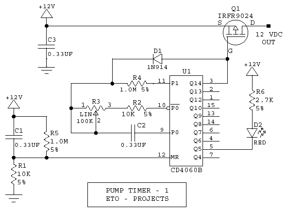

10 minutes is a loooong time for a single RC timer stage. With a 1 meg resistor, the capacitor for 10 minutes would be around 500 to 700 uF, so large that its leakage current might be close to or even greater than the charging current, leading to serious timing errors that would change with temperature. Another approach is an oscillator with a much shorter period followed by a multi-stage divider, like the CD4060.
When power is applied the counter is zeroed out by R1 and C1, and then starts counting. Output Q14 is low at this time, holding Q1 on, and input DC power is applied to the output. R3 adjusts the oscillator frequency, and hence the timer period. After 8192 counts, Q14 goes high, the output is turned off, D1 inhibits further counting, and the circuit just sits there in the off state. Cycle power to restart. There is no information about the load current requirement, so the power MOSFET should be adjusted for that.
In this example, the "timing" capacitor is a small ceramic cap, 0.33 uF. This is 1,650 times smaller than the cap required for a standard 555 monostable circuit with a 10 minute period.
Edit - added LED to indicate timing activity.

I agree with AK's solution. I used a 4060 a long time ago for a bathroom extractor fan timer and it has not given any problems since it was installed. (Probably about 20 years ago) I was thinking of suggesting the 4060 but has not yet worked out a simple way to stop the clock when Q14 went high. A very nice design AK. well done,

I tried to make that point in post #7. The leakage current in the cap becomes a consideration with large R and long time periods due to aging.

Thanks. You can replace the power-on-reset with a pushbutton for a very-long-period retriggerable monostable. Multi-hour delays are possible with relatively small, stable capacitors. Many of the world's problems can be solved with a 4060, 4093, 2N7002, and some 914's. It's my go-to tool kit for long-time circuits.
