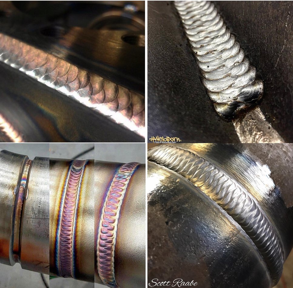

The have a technique now, weaving or walking the cup. I would like to try that.
These are from the Weldporn Facebook page https://www.facebook.com/Weldporn/
A clean style of overlapping infinity or figure 8 welding, the next inline weld would be fed under the previous weld before it cools. This would require an high setting of argon flow if argon types would be used.
