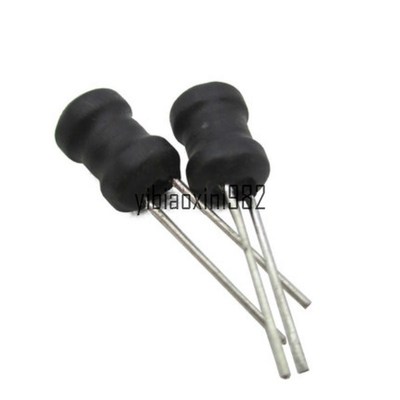

Actually before trying again, should I increase the inductor value first? I'm currently using inductors similar to this one in appearance:
If its the inductor then I guess I'll need to order powerful inductors. Until I own some could I get away with thick wire with many turns as a temporary solution?
Oh. wait I think audioguru just answered some of my question. Ok, I'll have to order a larger inductor. The biggest I have on hand is 1mH but he suggests 10mH+
Your inductor is like the low current ones in my solar garden lights. Its maximum allowed current is much too low for your circuit so it saturates and is simply a short piece of wire.

Ok, I'm looking on ebay right now and I already designed my PCB to fit axial based inductors. I found the same style that is rated for 1W but I also found ones that look like a cross between a resistor and a capacitor.
The 1 watt axial inductor (similar to what I have except this one looks thicker) is found at: https://www.ebay.ca/itm/20-PCS-10MH...al-10-mH-Color-Wheel-inductance-/121381924845
And the other one is at: https://www.ebay.ca/itm/20-Pcs-New-...mm-Radial-Leaded-Power-Inductor-/371707480726 and it looks like this:
Is a 1 watt rating good enough? I'm just wondering if theres some math I can use? I mean with resistors, I can determine wattage requirements with ohms law but I think with inductors its a bit different.
