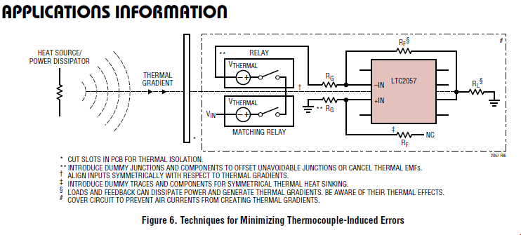

While researching this issue further, I came across this little app note showing some methods for thermal control see Image below.

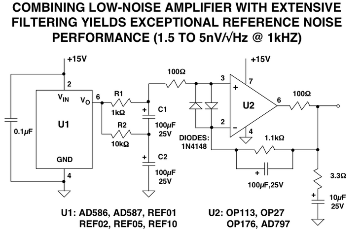

As far as output noise, I plan on filtering the noise using a output buffer with filter, I have a reference design showing how to do this, and can post it if anyone wants it. What the heck, posted below:)
