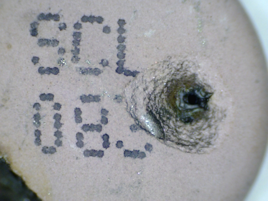

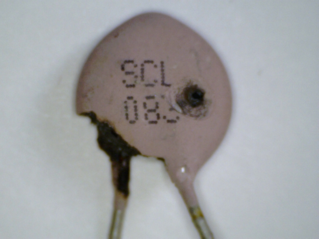

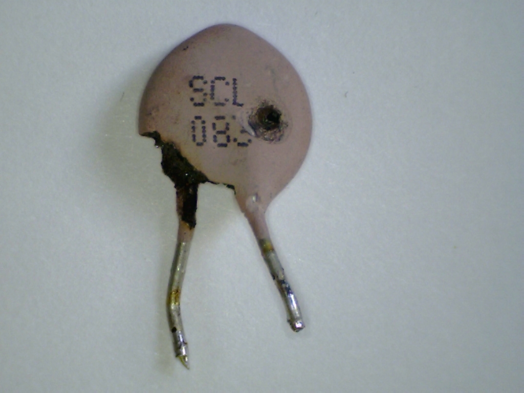

I have what the schematics say is a fuse resistor?
Can someone Please help me, can someone please tell me how to identify the value of a fuse resistor, it looks like a ceramic capacitor Disc, it has a SCL 083 On it about 10mm across and 4mm thick and a mustard color? thank you in advance.

That's what I have to do, but not tonight. The data for the 083 indicates a PTC. 8 ohms @ 25 C, 278 ohms at 3 AMPS and 33 s What kind of part belongs in the sub? I don't know yet.
If in series with the speaker, then 3*3* (guess 8 ohms + 8||8) or 12. P=9*12 or 108W (P=(I^2)*R)
This assumes 8 ohm thermistor and a 4 ohm voice coil) which isn't off the wall.
Inrush current limiters would be in series with the power.
That's a simplistic view.
Parts are tough these days. Panasonic HIDES the real part numbers. It did in 2000. In fact, some instrument manufacturer's in their revised manuals only had their part numbers. But fortunately, I can call one of the manufacturer's of an obsolete instrument and obtain the OEM part number if there is one. Any order, including parts, from the instrument maker has a $250 minimum though.
It's labeled as an NTC which is incorrect. It's main purpose is to prevent someone from putting in bigger fuses. Note the fuse symbol inside of the symbol for the NTC. It does provide some inrush protection because of the 8 ohm cold resistance. It also might help to provide some protection if 240 VAC is applied to the 120 VAC line voltage setting.
I do suspect that with a hole in the side it won't be the only problem. The voltage is around 400 VDC around that part by the way.
I think The hole in the side I think was caused by me running a surround sound test from the computer to the amp? I believe that the volume of the computer was to high!

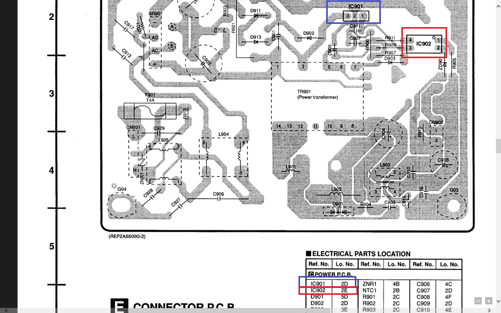

Because it was working as it should for all that day. as well as the RSQZAS500P14 having a hole in it the RSIZAS500P-4 "TOP227Y" has the front completely blown off! I am now trying to check the rest of the power supply.
Do you think that will be the only issue or do you think that it might be on the main PCB or the Control PCB.
Sid
Hi
No " IC901" has no front. / I believe IC902 is a optocoupler ?
ZD901 I think it's a zenor diode I checked this and it measures 0 one way and 0.726 the other way.
I put the other information to check with you to see if I have identified them correctly?
