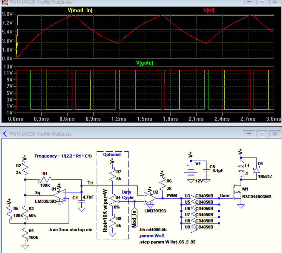

The CV 555 input only gives a limited range of PWM duty-cycle change versus voltage.
Much better to use a PWM circuit that allows a full-range adjustment of duty-cycle.
Here's an example of a simple PWM circuit using an LM339 that allows a PWM duty-cycle range of 0-100%.
