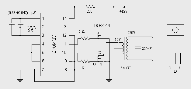

I have been involved in building inverters for quit a some time, and i have noticed some things about my step-up transformer:
1) the efficiency is less than 60%
2) the current drown at no load is more than 2.5A
3) A 2kva inverter cannot feed a load of 1.2kw (it starts smoking)
I Need you guys to pleas help me with all necessary calculations needed to achieve the turns ratio, number of turns and swg of the coil for a particular power of transformer?
I'm using 220v as inverter output voltage and 60Hz frequency
We need a lot more info, preferably a schematic, before we can diagnose the problem.
What are the transformers actual physical size and saturation characteristics of the iron being used?
Low efficiency of transformer can easily be caused by undersized core and/or poor magnetic properties or massive losses due to excess eddy currents in the core itself from improper laminating of the iron sheets.
i added two more fets to both sides of the fet cct to achieve enough power to drive my 1kv transformer of which I am having problem with winding and calculation.

For starters if you are trying to drive a 1200+ watt load with a 1 KVA transformer thats why it starts smoking after a bit.
Second a 2.5 amp idle load at 12 volts with a reworked 1 KVA iron core transformer and being driven with that circuit is not bad at all.

Still thats a rather poor circuit to use to drive inverter from being there is very little time delay for the switching devices to turn of and transfer to the other half of the cycle. A 5 - 20% dead band between cycle halves helps greatly with efficiency and power control on 50 - 60 Hz transformer based inverter designs such as this.
I think I saw that on a book but don't know how to make the delay with this ic. As for the transformer, I got it from a stabilizer rated 2kva
As far as IC's for inverters go using something deigned for inverter and other similar types of switch mode based power supply circuits is far better!
These LM3524 and LM3525 IC's are still around and cheap and easy to buy new or scavenge from circuit boards.

Post the specifications of your system, like input voltage, output voltage, primary and secondary wire gauges and no. of turns, core and window area. Efficiency of around 80 % with used cores at 1 kVA power level is doable. You also have to provide snubbers in the primary side to compensate for the high leakage flux associated with low voltage winding.
Current drawn at no load is "magnetizing current." If the input side parallel inductance is Lm, then the current drawn is I = V/X where V is the input voltage and X = 2pifLm where pi = 3.14 and f is the switching frequency.
Also be sure the two transistors are not ON at the same time, even for a short part of the cycle, as this shorts the transformer with much current drawn from the source!
