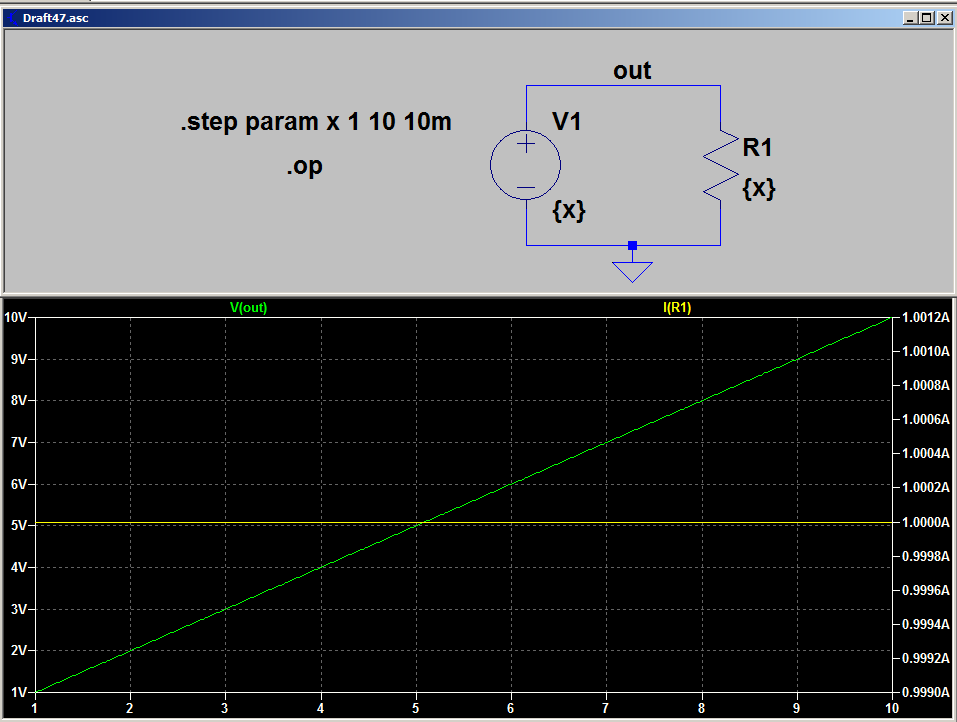

I got a question. Can you use the step command to alter two component values in LTspice? For 1 component, you put {X} for the component value. So if you wanted to step two part values how would the simulator know which part was what if two parts had {X} value and the spice directive is .step param X

If two different parts are controlled by param X, both vary as X does:
No reason why either or both part(s) couldn't be an expression which is a function of X, like {10*X} or {X*X} or {sin(X)}
