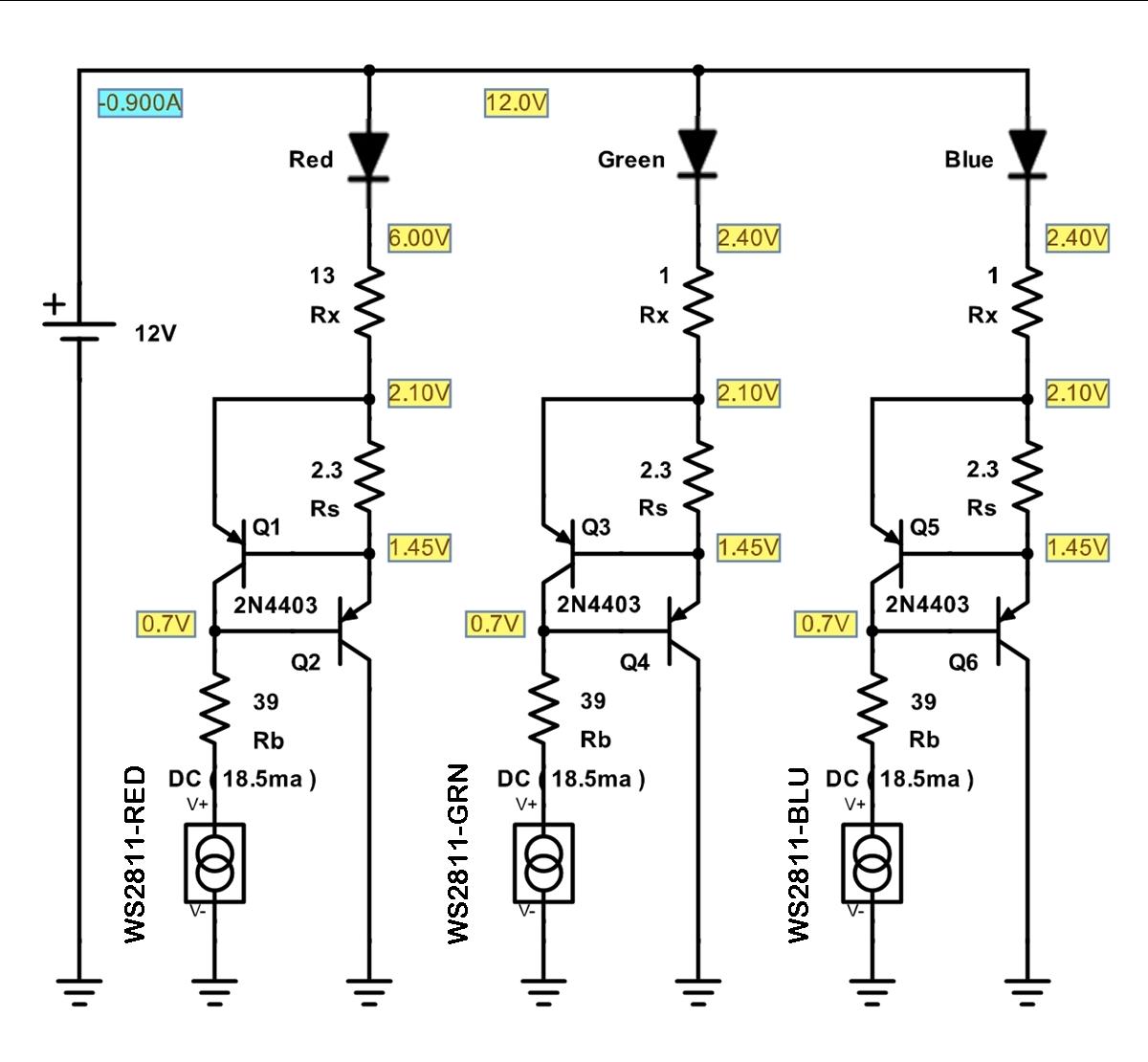

For a while I have been trying to find a pre-made board that is able to convert SPI signal (not DMX) to RGB to drive high power RGB Pixels (10W), to no avail. I had a previous post regarding this and gave up since I could not find such a board and it was cost prohibitive to manufacture. I originally gave in using WS2811 Pixel Board combined with an RGB amplifier. It was all good with the exception that I had no control over the LED currents and the pixel could easily overheat and self-destruct even with series resistors. Worth mentioning WS2811 is a 3-channel (18.5ma constant current) pixel driver that can receive SPI signal, buffers what it needs and pass on the remaining signal to the next pixel with no additional external clock. The buffer triggers 3 outputs to generate the color on the RGB pixel. This is done by a start bit, then sequence of 8bit for R, 8bit for G, 8bit for B, then a stop bit and auto latch. Its outputs can only "sink" (active low) maximum of 18.5ma per channel.
Operational Goal: Building a device that can receive SPI signal from microcontroller, or Programmable SD-RAM SPI Controller, or SPI signal from a DMX to SPI controller which utilizes DMX signal from a controller, or a PC program such as Light-O-Rama via a dongle. Device to have 3-Wires in/out (Data, +12, Gnd) for daisy chaining.
Searching on the net I came across a simple dual NPN CCR which peaked my interest yet it was not exactly what I needed since it required Positive trigger (Active High) to operate it. I reconfigured the design to use PNP transistors for Active low outputs of WS2811.
Objective: Build a device that is able to convert SPI to RGB
1- Be very low cost
2- Be very small (to fit an HP RGB metal case)
3- Be able to sink 300mA per channel (with flexibility to go a bit higher or lower by selecting Rs and Rx)
4- Use fairly common parts that are easy to find and inexpensive
5- Operate with minimum I/O wires (Single data line in/out)
6- Provide for constant current for each channel
7- Be able to drive 10W high power RGB module that runs on 12VDC
Parameters:
I-LED=300mA (under utilized vs. 350mA max)
Ideal Transistors: PNP To-92 Case, no heat-sink, Power Diss. = 625mW, hfe= about40, Ic=600mA, Vbe(on)=0.65, If Vbe(on) is not available Vbe(sat)=0.75 (example: 2N4403). Setting aside the board cost (board can be build dirt cheap at home and parts are thru-hole), the part cost is under $1 USD.

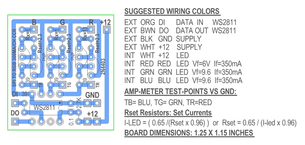

Here is the circuit simulated schematics and PCB layout (1.15x1.25 inches, 0.25 height)

I think the 50 ohm resistor is a problem. I think Rbx should be 0 to 5 ohms. (maybe 10 at most)
I think the WS2811 can not pull down to zero volts. (more like 0.4V)
Where did you get this from?
I built it in a simulator and a spreadsheet. When you reduce Rbx, you will increase Ic2 and that reduces I-led. Please note Vb2 = Ve1-Vbe1-Vbe2, I let the calculations lead me to Rb2.
Lets say Blu LED: Vf=9.6v, I-LED=If=300ma, Most higher powered PNP transistors in T0-92 package have a Vbe of about 0.7v. So Ve5=Vdd-Vled=12-9.6=2.4V
Setting Vbe5=0.7 (basis for current set), Vb5 is approx. equal 1.7V. Similarly Vbe6(sat) is somewhere between 0.75 to 0.9. Therefore Vb6=1.7-0.7 or about 0.8 to 1V. Based on simulation Ie5=12ma and Ib5=o.4ma, Ib6=6ma so Irb6 is about 18ma. Therefore Rb6=Vb6/Ib6 or Rb6 is somewhere between 45ohm to 55ohms. The closest value and average is 50 ohms. If output of WS2811 does not hit zero and is about 0.2-0.4v then Vrb6 is reduced by the same and Rb5 would be between 22 and 33. It is not that citical because when you raise Vb6 you are pinching Q5, reducing Is and I-led slightly. Which is the whole point of this circuit to have some flexibility. I pulled up all the possible To-92 PNP packages from MOUSER that had Pd=625mw, Ic=600ma, hfe=40 and Vbe(on) is about 0.65-0.75, Vbe(sat) is about 0.8-0.9v, Vce(sat) about 0.4v min.
Ron thank you for encouraging me to read the datasheet once more. I think the 0.4 you are referring to is under Vo. I believe this is indicating the output level of Data out and not R/G/B sinks to ground voltage. Look a bit lower when they have 3 LED in series and how they calculated RR (Series resistor for Red). There is no mention of deducting for 0.4V before dividing by constant current of 18.5ma!
On that note the constant current allowed by WS2811 is 18.5ma per channel. So Irb2,4,6 should be monitored not to exceed that and 50 ohms does exactly that. Positive side, you made me look closely at currents and voltages and made me realize that the series resistor that I used for WS2811 in the PCB layout needs to change from 1.2k to 2.7k. Thanks.
-Rom

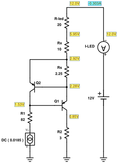

Real life:
1) 12 volt supply might be +/-5%. With long wires the voltage could be lower than you think. With 0.9A and wires there will be loss.
2) The voltage drop on an LED is not temperature stable. The voltage will change with temp. and from part to part.
I don't know what current you asked for from the WS2811.
I am not sure what voltage the WS2811 can pull down to. It is "constant current". If you pull less than that current it will pull as low as it can but what voltage?
I did a series of tests with the supply from 8V to 13V just for fun. I also changed the voltage across the LED to see what happens.
So the IC wants to output 18.5mA +/- some amount. So that 18.5mA adds to the current from the transistor.
What I think you want is a constant current transistor amp that holds the current the same over a range of LED voltage and supply voltage.

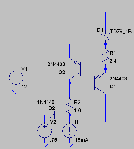

This is what I have in SPICE. The diode D2 and Voltage 0.75 volts are used to keep the current source from going negative. It holds the voltage to no less then about zero. (this is only to make SPICE work, not for real life)
I am using a 9.1V Zener as a LED so I can change the voltage on the fly.
R2 is basically removed at 1 ohm.
The voltage at the current source is not zero. It is what ever it takes to work. It changes to compensate for the supply changing.
Example: If the supply changes, the voltage at the output of the IC also changes to compensate.
Most of the 18.5mA goes through Q2 to the LED.
The Q1 current is set by R1 and 0.7 volts.
If R2 has too much voltage across it then the IC can not pull Q2 base low enough at low voltages. (or at high LED voltage)
By removing R2 you can run with a 0.8V less supply. (or 0.8V of loss in wire) (or with a higher LED voltage)

You changed the order of Q1 and Q2. My references below is to your schematics.
But I am not sure what you are referring to by "IC", WS2811?
I was trying to simplify the circuit, now you added another constant current source. I think I understand your concern with voltage drop but that would be minor.
Wouldn't I-led and transistors Vce and Vbe follow a very quick ramp until Q1 gets saturated? Meaning Vbe, Vce, Ie, Ic and Ib all shift to create that ramp with Vdd voltage changes and cutoff below certain level?
What if I disconnect the emitter of Q2 and tie it direct to Vdd (12v) separately with an added Resistor. That way the LED is in the path of only Q1 (load transistor) forcing Ie2=I-LED=Irs=0.7/Rs
That changes Rs to 2.3 ohms for 300ma I-led. This will provide for a separate current source for Q2 that gets sunk into WS2811. For that we can set the current at 18.5ma and recalculate R2 as needed! This way I believe the LED will be ran as a constant current almost independent of VDD up to a point (accounting for losses and fluctuations of Vdd). I am going to run a simulation as such.
Post #1 starts out with the WS2811. (that is a IC) Its output is a constant current source. It tries to keep 18.5mA on the LEDs (is connected directly).
In my SPICE circuit I did not show the WS2811 because I don't have one in software. Because its output is just like a constant current source that is what I used. The output of the WS2811 should look like a current source when the voltage is between 0 and 12V. (probably more like 0.5V and 11V but I don't know)
I think your circuit is OK. You are thinking in voltage mode and I am thinking in current mode. I started out with the idea that I have 18.5mA and I want 350mA independent of voltage.
When I simulated your circuit, as soon as the 12V dropped the current also dropped.

Based on the simulation of the new circuit:
Vbe2=0.64 (it does not reach full saturation)
Vbe1=0.75
Vb1=Ve2-Vbe2-Vbe1=1.53
Ie2=303-289=14ma
Ib2=< 0.28ma
Ic2= 13.72ma
Ic1=284ma
Ib1=4.78ma
R2 is used to take the power stress off of Q1
Rx is used to take the slack Vf difference between Red and G/B also to bring down the voltages to take stress off Q1 and Q2
Pq1= Vq1 x Iq1 = (2.28-0.85) x (303-14+0.28)= 413mw (within specs with room for deration)
