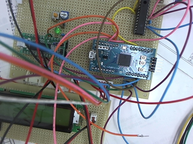

I am building a system using SPI. I have implemented several configurations on a breadboard and they work great. I use the following boards (sorry in japanese) that are basically fancy versions of the PIC 18F4553 and 18F2553.
https://akizukidenshi.com/catalog/g/gK-06720/
https://akizukidenshi.com/catalog/g/gK-08010/
I also use a simple PIC 18F2550
The problem is when I tried to put this configuration on a perfboard, they fail. In one case they transmit correct characters sometimes and incorrect other times. In the other case the slave only transmits 0xFF.
I have checked and double checked. The connections are ok. The programs work (on the breadboard that is) correctly. I have run out of ideas of what could be wrong.
I know it is a mess of cables but I ve originally neat thin lead cables on the back but they didn't work so I ve tried these cables...
Any, and I mean any ideas that can give me some light are welcomed. Need some help here.

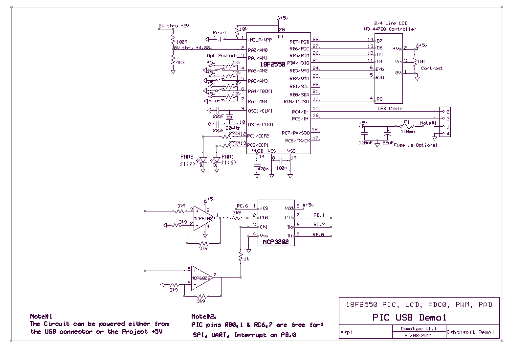

This is a diagram of the 18F2550, SPI project that I use, works OK.

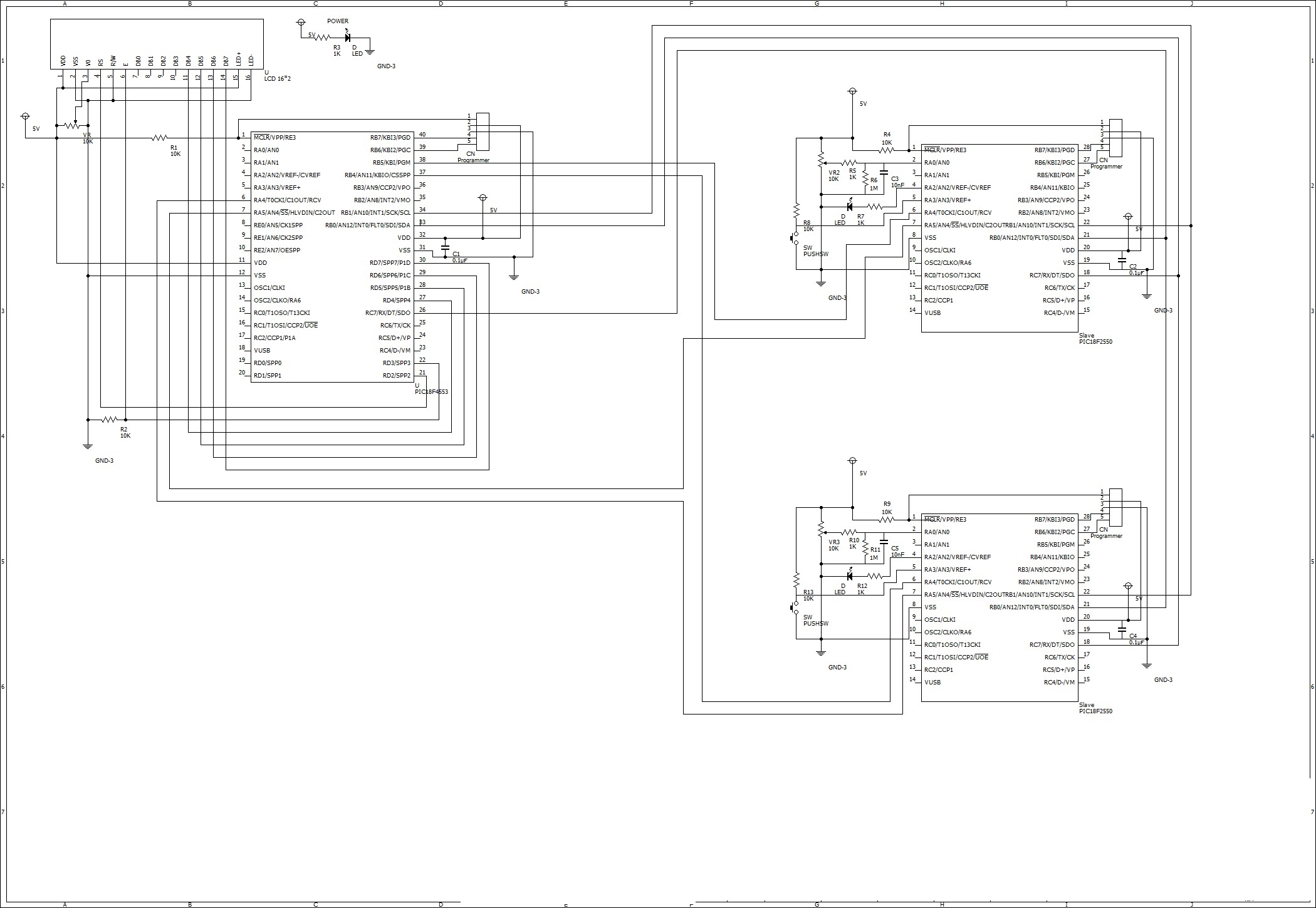

Here you are
This schematic works perfect on a breadboard btw.
Wait, you said it does not work on a breadboard as in your picture with long wires, so which is it, it works or not? Do you mean it works if you run a simulation? I am having trouble viewing your schematic.
I don't see much in the way of power supply decoupling there, maybe try adding a few 10uF and 100nF caps across the supply pins to your modules?

ummmm I see the pic gets too small... how about this?
Could you explain this to me please?... you dont mean caps between 5V and ground, do you?
That's exactly what I mean. Now that I have looked again at a close up of the photo you posted, I can see that you have fitted 100nF caps across the supply pins, try adding say a 10uF cap right beside each of them. Also, keep your inter-connect wiring short.
On any of your pic's I would not let the PGM pin float , check the data sheet .... did you have to cut any tracks on this board or is it just pads ?
