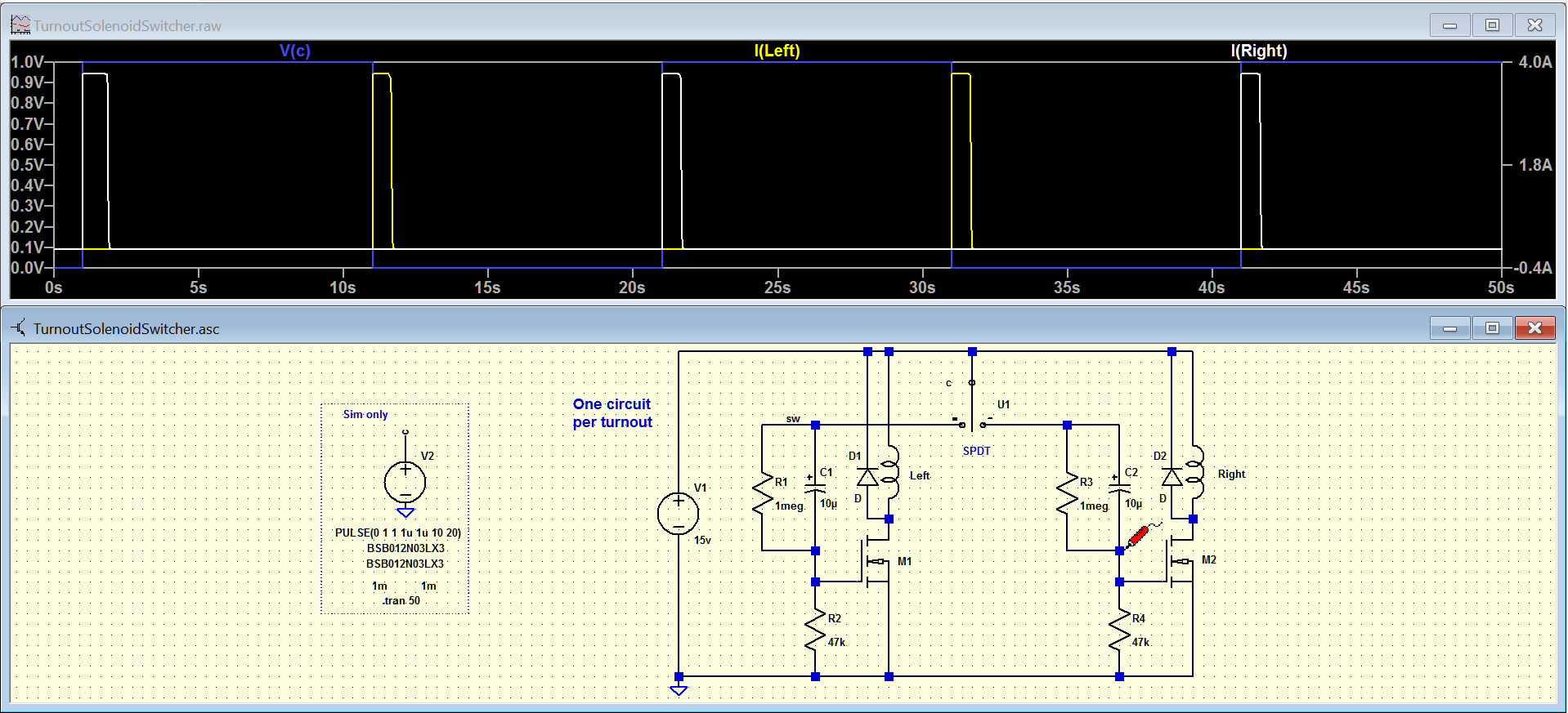

How about this? It needs one such circuit per turnout, but does enable an ON-ON SPDT toggle switch to be used both to trigger a pulse (about 0.6 sec with the components shown) and to provide the required direction indication.
Impressive! Where do you get that program from, what is that?
However, one circuit per turnout? Not economical I think, and centralisation is important to facilitate later extensions, expansions, automation projects,..

Still Requires the Center Off Switches and it will Work but Costs more since you need one of these circuits for each set of Solenoids.
Also the Heat in the Mosfet will Increase as the Gate Voltage Decreases.
No, it doesn't. Current pulse lasts only while C1 or C2 is charging.
MOSFET dissipation is ~8W for ~60mS, once per actuation of the solenoid. So average power is negligible. No heatsink necessary.

Great! Would the SPDT switch (ON)-centerOFF-(ON) switch not have to be one where the center position is the standard rest position?
alec_t, your proposal requires one pcb with components per turnout: this is not only more expensive, it would also require 3 wires from the control panel to each turnout, same as with a centralised solution (chemelec).
Case 1: SPDT ON-ON switches cost €2.23/10, plus the DPDT pushbuttons @ €3.84/10 versus Case 2: DPDT (ON)-centerOFF-(ON) switches that cost €6.80/10. Case 1 also requires more wiring, so cost still higher. Chemelec, your last proposal is the best.
Except in case 2 I have to provide LED feedback on turnout position because a center-off switch does not show that.
