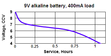

Hmm ok ithink i got it. It might be more complicated than i can handle. How long do you think i would get with just a 9v?
A 9v alkaline battery can put out about 500mAh, so if your fan draws 500mA that means it will run for an hour. It probably draws a little less than that, like 400mA or maybe even 300mA, so it may last an hour or a little longer.
We don't know how much current the fan needs. Its current draw is less at 9V than it is at 12V.
A battery is rated to deliver a certain amount of current. Its voltage drops as it runs down.
I showed that if the fan draws 400mA then a brand new 9V alkaline battery voltage drops to less than 7V in 15 minutes when the fan might stop or will not start running.
