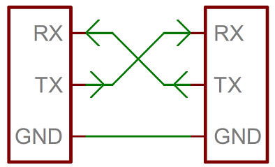

3V can usually drive 5V logic but needs series R to limit input current to 3mA for the ESD/SCR diode rail clamps for accepting 5V into 3V chip.
Thresholds are less than 50% for this reason and others.
But I think maybe it is more basic. Did you cross Tx. Rx? both pins should be high.
for TTL High is idle with low as startbit. and for RS232 it is inverted to positive logic..
