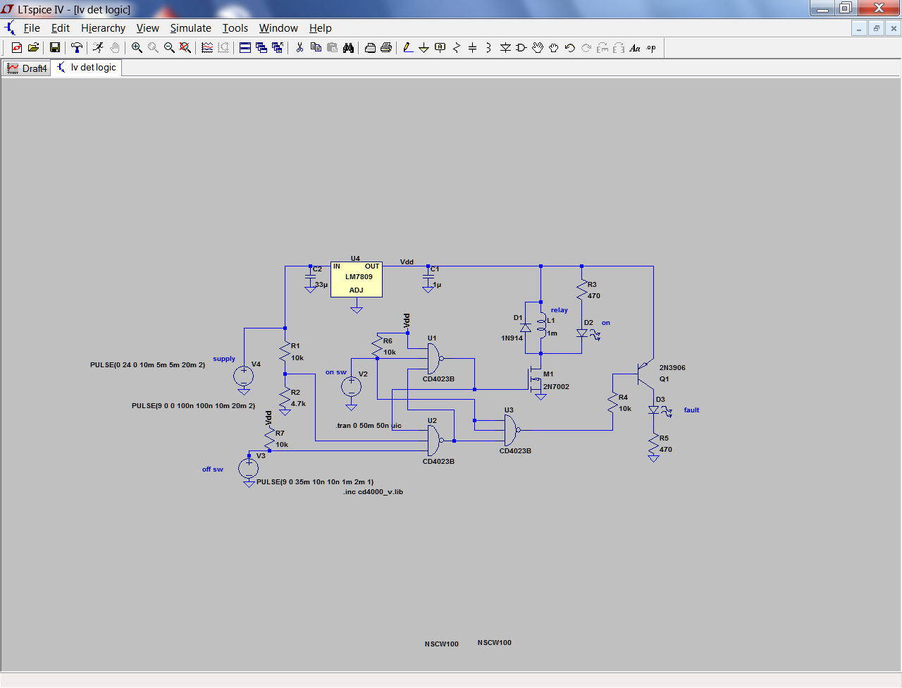

Here is a take off on 4pyros idea. Gets back to one switch.
Couple of things.
1-The red light will be on when it is plugged in. Maybe not such a bad thing.
2- You will have to hold the off switch in the off position until the power supplies drain or it will turn back on. This might be a problem. Might want to check that time with no load again.

I get the off circuit but the on switch would have to be a momentary to work wired like that other wise it would keep bypassing the relays the hole time its on.
I just drew in a neon bulb for the red one.
Yes, momentary on / momentary off.
I suppose we could use a toggle switch. You can get them in on, nothing and momentary. That would help the off time problem, but give a no mans place in the middle. With a rocker switch it is kind of natural for it to pop back to the middle.

Here is a better one using logic instead of comparators.

Since your the designated marketing guy we should disclose the warts:
On a fault the red LED will not stay on, but will go off as the supply discharges.
When you turn it off the red light will also come on until the supply discharges. We could make it go off as long as the switch is in the off position, but it would probably come back on after you let go of the rocker since the supply takes a few seconds to discharge.
Maybe the resistor used to power them up could be tripped if the leads touch?
nevermind on short circuit protection...it does have it already built in after all.
