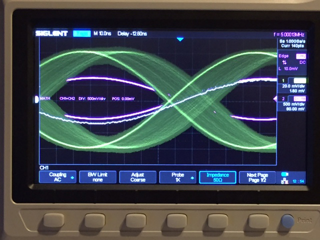

Most scopes these days have a 50 ohm input impedance setting. :)

I don't quite know where you got 'most' from, I've never seen one that did :D
Perhaps specialised scopes for RF use do?.
Whens the last time you shopped for scopes? Even my low end scope has a 50 ohm setting. It is useful when connecting 50 ohm coaxial cables. Besides, aren't scope BW in the realm of RF these days?

It is quite interesting to see the difference in display between a scopes 50 Ohm input and the 1 M Ohm input, not to mention the difference when a 10:1 probe is fittted to the scope.
