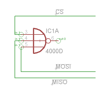

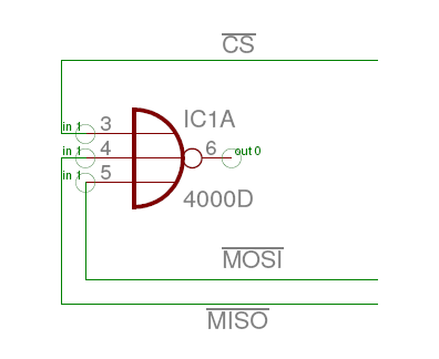

What is the lame schematic software that you use? Last I recall, you did not use Eagle. However, in Eagle, just precede the name with an exclamation mark like this: !CS . That will then show with a line over the symbol meaning active low. For nets, it will show like it is written, e.g., !CS. For pins, it creates a line-over, like this:

Here's a silly example:
It is easiest to use when making a device. BTW, The origins show for grabbing and moving. They don't generally print. I used screen capture, which is why you see them.
Here's what a snip from a print looks like:
John

Does that character create a line-over in the programs you have used? I thought Mikebits wanted something that would result in the widely accepted line-over in whatever drawing he is working on.
Later the issue of exporting netlists to a simulator came up. I do not have the current Eagle simulator plugged in, but the net list created by Eagle is "!<name> ." I presume its simulator tolerates that, but have no ready way to test it.
John

No Derstrom you did not misunderstood, you are correct. John what is up with input lines going through the body of your gate?
Didn't you understand what I meant by "silly?" That was not the point of the illustration.
John
Sorry John, I was just not sure if that's how Eagle drew the symbol.
