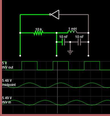

Another thing, you said in post #128 that the filter network changes the phase by 180°. I believe that is wrong, and I should have caught it earlier. A passive network can only change the phase a maximum of plus or minus 90°. Since the circuit is at resonance, there is no orthogonal component to the input of the inverter. In other words, the phase change is zero from the output of the inverter back to its input during resonance. In fact, I theorize that if you connected a straight wire from the output of a inverter to its input, it would oscillate with its frequency depending on the slew rate of the inverter and other internal parameters.

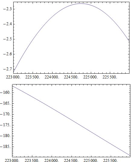

Another false claim you cannot backup which is basic 1st year stuff.
The order of a filter can shift 90° per reactive element unless equivalent.
A passive network can shift thousands of degrees in high order filters not just 90°
Regardless of your lack of awareness, I had already showed simulation of the filter's 180° phase shift.
OK, I will concede that point to you. I should have run a Bode plot on it. But tell me, if a positive voltage is applied to the inverter input, the output will be a negative voltage. Then the network will change it to positive again for the input. So why doesn't the inverter lock up to its positive input value?

Good question.
At DC zero filter phase shift, you have just negative feedback to self bias at the input threshold , typically Vcc/2.
At AC resonance, phase shift is 180 deg. + inverted out gives positive feedback and as long as gain >=1 it will oscillate.... Gain >1 grows to saturation at a rate depending on gain
Eratta
If you have hysteresis with an inverter then with R feedback and C input, it oscillates as per your description..or . Astable Multivibrator., the term given to RC types with delay induced positive AC feedback with logic level dependancy and sensitivity to R feedback current

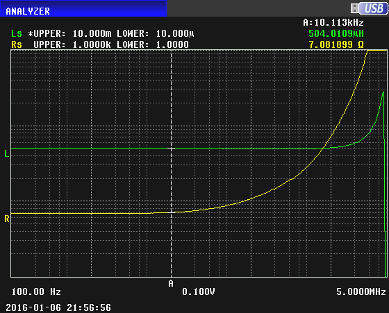

I don't have a 1 mH inductor of this style, but I do have a 1/2 mH one. Here's a sweep of the inductance and AC resistance of mine from 100 Hz to 5 MHz:
The SRF is plainly visible at about 4.5 MHz. The OP's inductor SRF will be somewhat lower. The DC resistance of my inductor is 7 ohms, and the AC resistance begins to rise a little below 10 kHz. The OP's inductor probably begins to experience a rise in AC resistance at a somewhat lower frequency, but with a DC resistance of 13 ohms, its AC resistance is probably still well below 100 ohms at 16 kHz.
His original method of using a 100 ohm resistance in series with the inductor would work ok with the technique of measuring the voltage across the 100 ohm resistor and across the inductor (with its series AC resistance) differentially, adjusting the frequency until they're equal. Since the reactance of the inductor and its AC resistance add vectorially to give the impedance, as long as the AC resistance is below 20 ohms, the error is only about 2%. With a much higher frequency, the unknown rise in AC resistance will begin to become a significant part of the impedance, introducing substantial error in the inductance measurement.
Worse for his stated purpose, making a tank for an AM radio, the AC resistance will be quite large in the neighborhood of 1 MHz. As I told him in an earlier post, this inductor is not suitable for that purpose.

I didn't say anything about whether or not you should stand by your previous comments. Plots of Z vs f are in the manufacturers data you linked to in an earlier post: https://en.tdk.eu/inf/30/db/ind_2008/b78108_148s.pdf
My plot is just showing the parameters in a form more directly relevant to the OP's problem.
