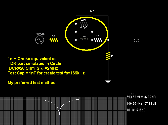

In any case if the user has a generator, the preferred more accurate method uses a known accurate Cap to resonate and compute L from this independent of any loss resistors in source choke or load.
I modeled a TDK part exactly which is also the general model.
https://en.tdk.eu/inf/30/db/ind_2008/b78108_148s.pdf
Note LowFreq loss is shown in graph as 10Hz=-7.6dB instead of -6dB because of DCR = 20 which accounts for additional 1.6dB loss
Note High Freq loss is shown well above resonance with ideal 50 Ohm resistors and measurement methods.
Thus Simulation shows -6dB as leakage capacitance which creates the SRF of 2MHz on its own has no effect with 1nF added to the part.
The OP probably does not have access to a standard capacitor or a cap tester that can be traced back to a standard. Also his generator does not have the range you specified. The circuit you specified is too elaborate and expensive for most hobbyists.

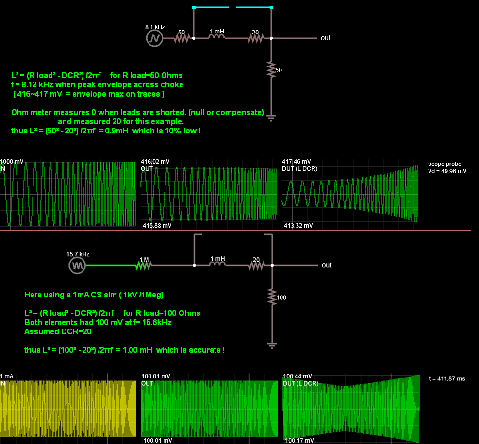

YES Elerion, If probes are matched, ( so that if applied to same signal would result in flat line(0V) it appears correct.
Recheck DCR
Recheck f for equal component voltage. "L+DCR" & Rload
then solve for L
from my post #40 you have 2 choices.
1) Subtraction by solving for L
√{X(f)²+DCR²}=100Ω at equal voltage point for OP's original question.
or L² = (100² - DCR²) /2πf
2) ignoring DCR by make R load bigger like 10k instead of 100 instead of smaller ( recall he could not generate higher f.)
using same L² = (10k² - DCR²) /2πf then DCR is negligible for f the point where amplitude is equal.

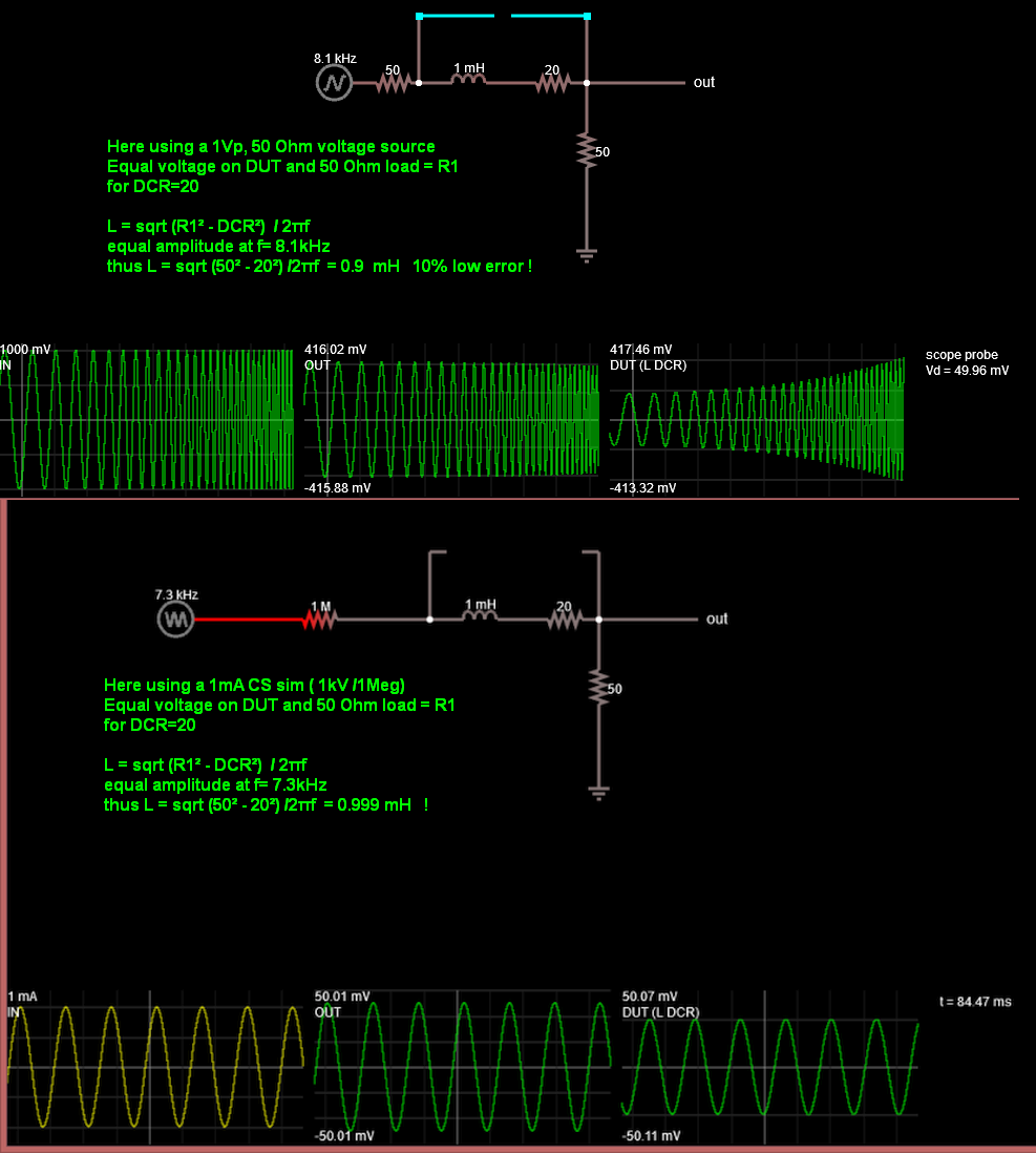

there are differences in L for a voltage source vs a current source. Why ?
same DM magnitude criteria is used for DUT and load R.
L = sqrt (R load² - DCR²) /2πf same formula as Mr Al
... Vector Algebra
... Vector Algebra
The denominator for your formula on the image should be (2*pi*f)^2 , not 2*pi*f . The calculations are correct, however. It should not matter if current driven or voltage driven as long as the DV's are equal across the components. If the AC resistance is significant and not taken into consideration, then the value of L will be calculated higher than it should be. It might explain why your L value at the higher frequency is higher. That is why I would like to keep the frequency as low as practical.
Ratch
typo corrected. However simulation including DCR still shows a discrepancy in results.
