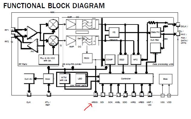

Hi! I want to use RF signal for my thesis project. I want the receiver to detect rf signal and set a signal strength threshold, if the threshold is reached the output on the receiver will be logic 1.. Can a cheap RF transceiver can be programmed to set signal threshold? And if can.. i want to know how to do the code.. I just need an rf with a range of at least 50 meters.. Can i get your opinion on this guys? please help

Read the stuff on Roman's web site I linked to. There is no "threshold" on a super-regen receiver; only random pulsing if no signal is being detected, or the on-off detected keying envelope if receiving an on-off keyed carrier. The only way to tell if the receiver is detecting signal vs random noise is to look at the temporal information in the detected output signal using timing or possible tone detection. Read Roman's article very carefully. It explains this very well.
The output from the receiver effectively differentiates the RF envelope from the transmitter. There is no output that is proportional to the "strength" of the received signal. If you are trying to "measure" distance between the transmitter and receiver, you will need a different kind of receiver (superheterodyne, or Tuned-Radio-Frequency).
As I recall, the purpose of a thesis project is to demonstrate ones proficiency in a given area. A thesis project often includes a detailed write-up along with an analysis, and sometimes an oral exam. I would think you should be fairly far along in your studies, so for you to be asking for someone to provide you with code just amazes me. Anyways, Hope RF makes a module (RF12B) that provides a received signal strength indicator pin. You can get these modules from Sparkfun. The datasheet can be download from this link. **broken link removed**
