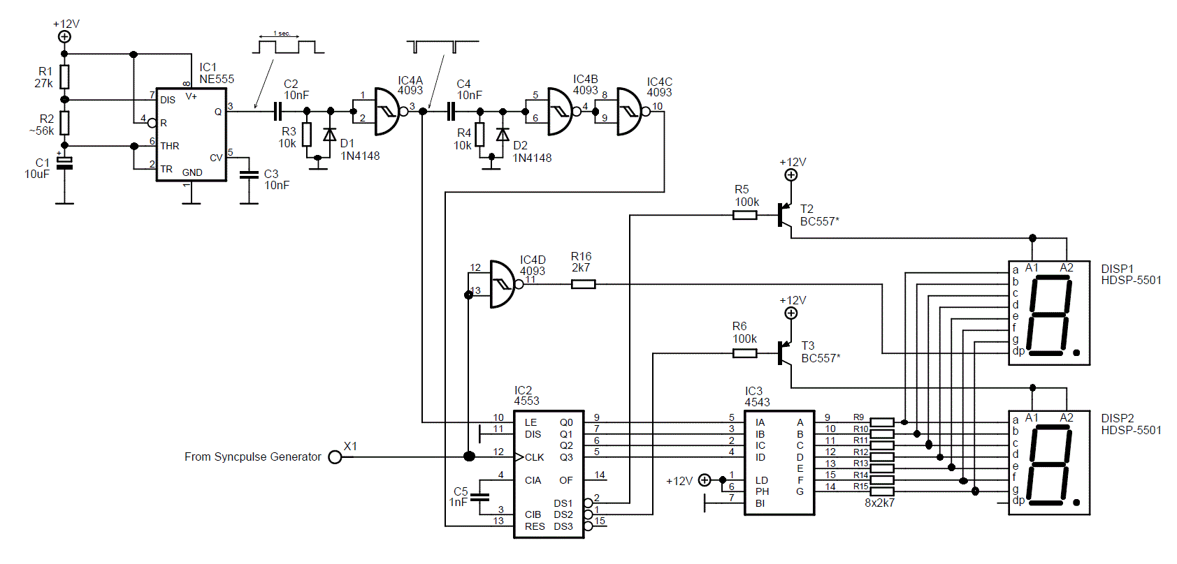

I hope this is not the wrong section of the forum, but I think I can connect my question to this post because the topic appears to be similar ...
Sorry, I'm here to ask for help.
I need to modify a circuit schematic because the CD14553 and CD14543 are not more available on the market.
Around there are a lot of schematics that use the CD4026 as 'all in one' counter and decoder,
but I'm not able to replace, with operational certainty, the 14553 and 14543 using the 4026 (or, perhaps, CD4033 ?).
Below you can see the schematic that I need to adapt, leaving in their place, the two display, the 555 and the 4093.
I need to replace only the 4553 and 4543, and, possibly, I do not know if it is necessary,
to recalculate or delete the resistors and the two transistors.
Kindly, could someone help me rewriting the schematics or or suggesting an identical alternative?
I need to realize this PCB, you could suggest even a cheap chinese PCB board that do the same-identical work
and that accept external trigger input as in the schematic.
If you need more infos ...I'm here.
Thank you for reading.
Regards.

I'm from Italy, I found some foreign distributors that have some 4553 and 4543, but the cost is impressive and I have to add also shipping cost.
I have not yet figured out whether it makes sense to use a 4026 or if it is better to look for another solution.
Looking at the datasheet of 4026, I do not know what to connect, according to my diagram above, to pins 2, 3, 4, 14 of 4026.
Furthermore, it seems that the 4026 does not have the "Latch Enable" taht in 4553 corresponds to the pin 10.
CD40110 is a current part ($1.50 US) and has an internal latch, so it is a better single-stage replacement for the 4553. Also, unlike the 4026, the 40110 is designed to drive LED segments directly. The segment outputs are characterized differently from the other outputs, with sinking currents up to 25 mA.
The new circuit will be a significant edit, but in the end it still will be a 2-chip solution with 7 more segment resistors.
ak

I tried to edit the schematic, but it certainly is not yet complete.
I need help to identify any errors, also I do not know if (or how)
pins 9, 7, 4 of both 40110 (but also other pins), and the common cathodes of the display are correctly connected.
I think, but correct me if I'm wrong, that the resistors to the display may remain unchanged because the common cathode display that I've used, require 20 mA.
I use DipTrace to draw schematics, so I can send or accept .dch file
If someone wants to compare the initial/original schematic with this one, and report errors, I would be very grateful.
Again, thanks to all.
All inputs of both chips must be connected to something, depending on their function. Also, don't you want both chips to latch at the same time?
For the display resistors, 470 ohms will get you about 20 mA of segment current.
