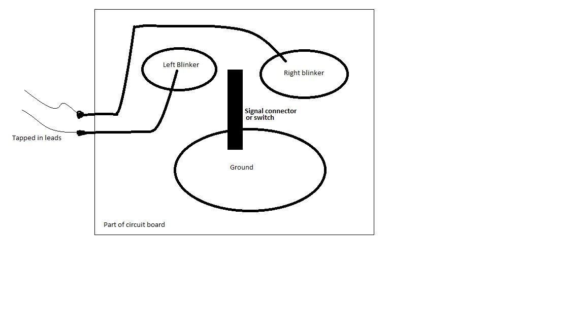

I am an MECP installer. I am trying to get a relay negative trigger from a circuit board in the headlight turn signal switch of a car. It is a data/low voltage system. When I hook a relay negative trigger to the negative trigger on the switch, I get back feed/interference on the headlight switch, because there is positive current grounding through it from the relay, and it changes the resistance/data in the circuit on the switch; which changes the signal to the computer and causes weird things to happen in the car. Once the relay is disconnected, the system goes back to normal.
I need to know how to isolate this or figure out another way to get this negative trigger. This switch seems to be the only way (after inspecting All Data diagrams for the vehicle), because after this constant signal is sent to the computer of the vehicle, the computer changes it to a non-constant/pulsing signal that I can't use.
My intent is to get a constant trigger for when either of the turn signals are started; so that I can switch an LED circuit to the turn signal circuit, instead of the parking light circuit it is at normally. On older cars you could hook into the negative trigger at the Flasher. These newer cars use a computer to flash the blinker which makes it more difficult.

Relay not connected. You should be able to measure the voltage with just a DMM, with the possible exception of the pulsing....
Okay so, the voltage fluctuates between high and low. I will give you the min and max of each ignition setting:
The right blinker:
Lock: 93.1 - 115.8 mV
Accessory: 97.1 - 116.5 mV
Ignition: 94.6 - 118 mV
Running: 94.2 - 119.8 mV
Signal on: 3.7 mV (not fluctuating)
The left blinker:
Lock: 66 - 78.4 mV
Accessory: 68.2 - 79.4 mV
Ignition: 66.1 - 80 mV
Running: 32.4 - 79.8 mV (might have been a mistake on the lower one, I can recheck)
Signal on: 3.7 mV
Its a very rough sketch, but that is what it looks like. If you want I can get a picture.
Is that measured with respect to chassis ground? I'm surprised that all of the voltages are so small. I would have expected signals that switch from near ground to near battery voltage...
Then you are not connecting to anything useful inside that circuit board. I think all you are seeing is ground drops, so your positive meter is not where you think it should be, certainly not where anything interesting is happening...
Headlight and turn signal drivers also sense current and low voltage drop to alert when expected load changes due to an open bulb or filiment ( mine has two filaments in parallel like DTR & brake filaments and the higher current one always fails 1st.
this gives redundancy giving one standby turning indication at lower intensity but still alerts dash with lamp error)
Therefore any sensing cannot draw or supply current.
i would use a comparator with threshold set to 10mV with 1k differential RC filter on input and open collector // reverse diode to drive 100mA relay or better a smart MOSFET switch.
As usual, protect against reverse voltage and 2x V+ surges
This comparator 36Vmax, 2mV=Vio, 20mA will do the job with suitable MOSFET . Scale 9 to 14.2V down to 10mV and compare with local ground nearest with twisted pair.(or UTP shielded?) or for more precision, use any LDO or any LED at 2mA for reference V to scale down to 10mV. e.g. Red =2V to 10mV needs 200:1 divider or ~ 1M to 5K to ground , other side 5 k to ground. 0.1 uF in between +-. And diode cap for Vcc to chip.
