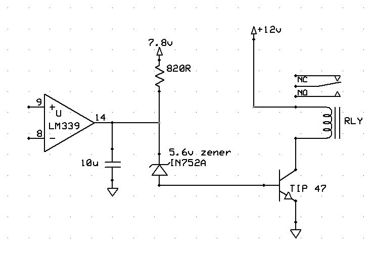

Is this circuit very close to being unstable as the relay chatters or clicks open/shut about once or twice a second at certain times.
I have measured the pins on the LM339 and 8 is 3.4v and 9 is 4.8v.
Pin 14 shows 6.45v
I assume the relay is about 300 ohms and so expect around 40ma through the TIP47 but could be more. The relay is a DPST that switches 240v mains.
It seems the base of the TIP47 is quite close to the limit of turn on/off and if the 7.8v supply fluctuates (seen just a drop of 0.1v at times) by just a little could it cause instability. Not sure how the 5.6v zener effects way it works?
Any ideas how to fix this or is this circuit good and therefore I may have to look elsewhere?

Not exactly sure what you are trying to do, but..... Try making the resistor 8.2k. The 339 can not drive so much current. Then I think you can remove the capacitor and the zener and it will work.
ronv - this is an old circuit on a board that has recently started to chatter the relay and as this is the controlling part of how the relay is turned on and off I can only assume it is fragile or as components age it gets close to a problem!
What do think a LM339 can handle, when pin 14 goes low it just falls to 1.3v and I thought 9.5ma would be OK for it to sink so is the 339 overloaded?
Also not sure what the 10u does - is it a sort of soft turn on. It is a pretty strange cicuit and trying to figure it out.
The 10u cap will ad a small delay between when the output of the 339 goes high, and when the relay trips. The cap has to charge up to about 6.3 volts to trip the cap. The problem is that the BE junction of the bjt also acts like a zener such that the cap voltage stays right at the threshold of the Vbe + Vzener. As such, the transistor is always just barely turned on. Any variations in the Vbe and/or Vzener due to thermal (or anything else) will cause the transistor to turn off until the cap voltage adjusts.
If the circuit needs the delay caused by that structure, leave the parts as they are with one addition.
Insert a small resistance (10 to 100 ohms) between the zener and the base of the transistor. This will allow the cap voltage to go a bit higher and the base of the transistor will see a current source instead of a voltage that is barely enough to turn it on.
That should clear up your chattering problem.

No idea why the zener is even there and the logic behind the 339 is simple, if there is AC volts available then the 339 goes high and if the AC is not present the 339 goes low. That is all there is to it so the cap and the zener seem redundant as there is nothing else connected to that part of the circuit.
Even so I am still a bit confused as if a 10 to 100 ohm resister is placed between the zener and the base would it not just reduce the current to the base?

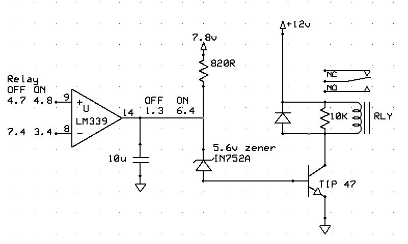

I have attached a an updated schematic which also shows the fly back diode alluded to by Alec as I found it a way away from the rest of the circuit.
So I measured the inputs to the 339 and the output and the volts are shown in the schematic, These readings are all very stationary and I do not see small fluctuations.
Maybe I should be looking outside the box, poor connections, Knackered relay, temp breakdown etc as this only happens when the system reaches equilibrium.

Ok, so it's only DC at the 339 inputs in theory. Any brief output jitter on pin 14, due to spikes on that DC, should be caught by the cap, but it looks as though it's getting through. I'd replace the cap.
Pin 14 is pulled low and sits at 1.3 volts. This seems strange as one would expect it to sit at near 0v
As per the datasheet the 339's sink current may be as low as 6mA, so it's not strange. 6mA through 820Ω would drop only 4.9V below the 7.8V supply, i.e pulling pin 14 down to 2.1V.

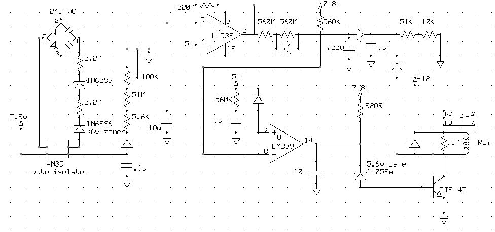

So the mains passes thro a bridge rectifier and then a voltage divider, the result is opto isolated via a 4N35 to further voltage dividers and is then input to another 339 - the output of that 339 via more voltage dividers drives the pin 8 of the 339 in question.
Unless the rectified mains is smoothed, the input to pin 8 will have a strong 100Hz (or 120Hz) component. So not fixed DC (although your DMM may be telling you otherwise).
pin 9 is fixed at 5v.
Or should be? Could a bad solder-joint or interference cause a variation?

Looking at the circuit attached below it seems there is some filtering as the AC on signal travels to the pin 8

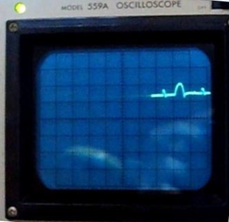

Looked at the +12v main supply line that connects to the batteries and also right next to the 16,000u cap and it shows a hefty spike on the scope trace - attached. Cannot get the whole trace as the video takes it section by section.
The GND is set 3 divisions below the centre so each div is about 3v, as the signal is around 13v looks right and the pulse is about 3 v on top so quite a powerful pulse, the small pulses are from the triac firing which is probably 100Hz so the pulse duration looks like 4 to 5 ms. The end of the pulse always coincides with a triac pulse on all of the 30 odd pulse the video caught.
Do you think that the power of this pulse is enough to make the xfrmr and all the power electronics make that noise. I did record the noise and maybe I could upload it - big file!!!
A 5 ms pulse would sound like a cluck - the obvious concern here is what is the nasty pulse going to do to the rest of the components?
