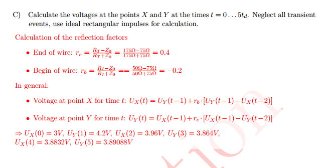

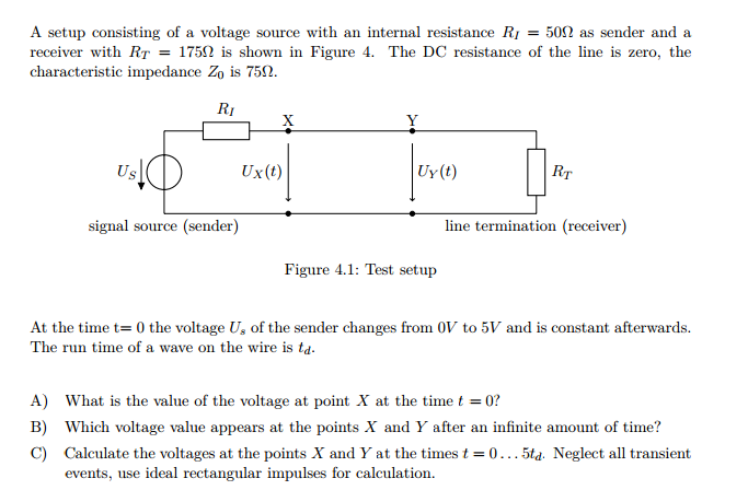

Hallo All,
I am new to this forum.I need some description about the some Reflection of wires in communication. I have attached the Picture of My question Along with Answers for details so I shall be really grateful to you people if somebody spares his time to solve my problem.
My Questions:
1- Can someone explain me please how he solved Part 3 as I need concept of it and I am not being able to get the whole concept.
I shall be grateful to you if someone help me out in it. Thanks a lot.
Question:
