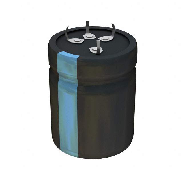

8200 uf, 75v, 85 degrees C and 1000 uf, 35v, 85 degrees C.
If you attach a picture of the capacitor we might know where to get them.
Screw terminals?
Solder into a PCB?
Distance from pin to pin?
