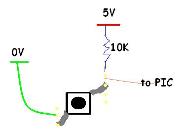

I recently got a pikit 2, its the 1st time that im using push button switches.
im using 4 pushbuttons. when i power the circuit The LCD displays "infrared liquid level detector" permanently, so the lcd code and initialising is working.
All i want for now is:
when i press ENTER/Settings button....i want "enter/settings" to display on the LCD. And that is not happening when i press the button. Please help me solve this problem....i attached a picture of how i connect the switch to the pic.
If thats how the buttons are wired then you have to check for a LOW signal.
like ..

Thanks ALOT AtomSoft...Im going to try that out now....

Uhmm its giving an error
illegal type for switch expression
illegal conversion of integer to pointer
[COLOR="Red"]switch(WaitForInput){[/COLOR]

oops try this:
switch(WaitForInput()){

hehe, the 1st 1 worked, now for the lol testing it on the circuit;)
heh good luck. I leave in about 1 hours for errands then come home then wait about 1 hours till i have to goto work. so enjoy and have fun. and if you need help ill try to post .
yay lol getting somewhere:). i tested it now.
when i power up without pressing switches it displays:
clears then
enter/settings
clears then
clears then
enter/settings
and keeps doing this.......
when i press the home button down continuously :
it displays
"infrared liquid level detector" continuously
thats correct because the home button takes you to the home screen
when i release the home button then:
clears then
enter/settings
clears then
clears then
enter/settings
uhmm im going to play around to see if i can get it to stay at enter/settings screen
Thanks again n again n again:). Im very happy now....that im seeing some progress.
Going to continue to make all the buttons work now. ill b back:)for sure

Hehe, that was a nice surprise:) when i logged in again. Thanks lol i hope you not counting how many times i said that :rolleyes: I tried the code. i commented home screen() in the main code otherwise it only displays infra red liquid level detector and ignores the button presses.
void main(void)
	init();	// initialise I/O ports, LCD
	//home_screen();
ALSO
it works when i replace:
char WaitForInput(void){
  char temp;
  while(1){
    if(!ENTERSETTINGS_SW){
        temp = 1;
        break;
    if(!HOME_SW){
        temp = 2;
        break;
    if(!INCREASE_SW){
        temp = 3;
        break;
    if(!DECREASE_SW){
        temp = 4;
        break;
  }//end of while
    DelayMs(20);    //debounce
    return temp;
with:
char done;
char temp;
done = 0;
while(!done){
        temp = 1;
        done = 0xff;
    if(!HOME_SW){
        temp = 2;
        done = 0xff;
    if(!INCREASE_SW){
        temp = 3;
        done = 0xff;
    if(!DECREASE_SW){
        temp = 4;
        done = 0xff;
}//end of while
    return temp;
if i dont replace it then pressing the buttons has no affect...it keeps displaying "enter/settings"
when i replace it and power on:
"enter/settings" is displayed continuously
when i press home button: infra red liquid level detect is displayed.
it does not display the full word "detector"
when i release home button: "enter/settings" is displayed continuously
when i press increase button: the screen remains blank
when i release increase button:"enter/settings" is displayed continuously
uhmmm it does not show the number of times the button is pressed on the LCD
when i press decrease button: the screen remains blank
when i release decrease button:"enter/settings" is displayed continuously
when i press home/settings button:"enter/settings" is displayed continuously
when i release home/settings button:"enter/settings" is displayed continuously

Can you post full code?
Try this:
#include <pic.h>
#include "pic.h"
#include "delay.h"
#include "math.h"
#include <stdio.h>
#include <stdlib.h>
char input_sw;
char mnuPOS;
unsigned char MyVal;
unsigned char MyValLCD[2];
unsigned char MyMaxVal;
unsigned char MyMinVal;
#define HOME_SW RC2				//HOME switch
#define INCREASE_SW RC3			//INCREASE switch
#define DECREASE_SW RC4			//DECREASE switch
#define ENTERSETTINGS_SW RA4    	//ENTERSETTINGS switch
void init(void);
char WaitForInput(void);
void home_screen(void);
void EnterScreen(void);
void ShowDigits(unsigned char val);
void main(void);
void init(void)
    OSCCON|=0x60; //set fosc to 4Mhz
	TRISB=0x00;
	TRISC=0xFC;
        TRISA = 0b10000010; 	// RA7 high imp, RA3 is serial out,
	ANSEL=0x02;            //set RA1 as analog input for GP2 sensor
	ANSELH=0x00;
	lcd_init(); //call LCD initialisation
char done;
char temp;
done = 0;
while(!done){
        temp = 1;
        done = 0xff;
    if(!HOME_SW){
        temp = 2;
        done = 0xff;
    if(!INCREASE_SW){
        temp = 3;
        done = 0xff;
    if(!DECREASE_SW){
        temp = 4;
        done = 0xff;
}//end of while
    DelayMs(150);    //debounce
    return temp;
void home_screen(void){
	lcd_clear();
	lcd_goto_L1();
	lcd_puts("INFRARED LIQUID "); //home screen message (line 1)
	lcd_goto_L2();
	lcd_puts("LEVEL DETECTOR  "); //home screen message (line 2)
void EnterScreen(void){
	lcd_clear();
	lcd_goto_L1();
	lcd_puts(" ENTER/SETTINGS ");
	DelayS(1);
	lcd_clear();
void ShowDigits(unsigned char val){
    MyValLCD[0] = val /10;    //returns the quotient (if temp = 35 the result is 3)
    MyValLCD[1] = val % 10; 	//Returns remainder   (if temp = 35 the result is 5)
	MyValLCD[0] += 0x30;	//to ASCII
	MyValLCD[1] += 0x30;	//to ASCII
	lcd_clear();
	lcd_goto_L1();
	lcd_goto_L2();
	lcd_data(MyValLCD[0]);	//to LCD
	lcd_data(MyValLCD[1]);  //to LCD
void main(void)
    DelayMs(20);    // init delay
	home_screen();	//display home screen
	MyVal = 0;
	MyMinVal = 0;
	MyMaxVal = 99;
	mnuPOS = 2;
while(1){
   	input_sw = WaitForInput();
    switch(input_sw){
      case 1:
      	EnterScreen();
		mnuPOS = 1;
        break;
      case 2:
		home_screen();
		mnuPOS = 2;
        break;
	while(mnuPOS == 1){
    	DelayMs(50);    //debounce #2 for a total of 200ms (user can press button 5 times in 1 second)
      switch(input_sw){
		case 1:
			mnuPOS = 2;
			home_screen();
			break;
      	case 3:
			if(MyVal < MyMaxVal)
      			MyVal++;
			ShowDigits(MyVal);
			break;
      	case 4:
			if(MyVal > MyMinVal)
      			MyVal--;
			ShowDigits(MyVal);
        	break;
	//Do something here with the new Value which is a decimal in MyVal.
Heres the code i used and remarked on

i think you might have a hardware issue. Are all the buttons pulled high?
As soon as it goes on it should not say anything. It should be blank and you have to press the home button for it to show that "infrared liquid level detector"

im going to uncomment home and c what happens. When i tried your new code....home is uncommented and the same remarks apply.
