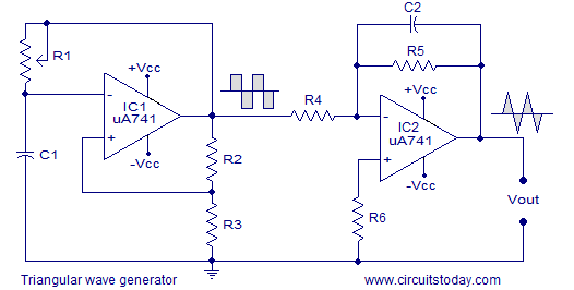

I would use two opamps to create a triangular wave generator, then use another as a differential amp to output a pwm..

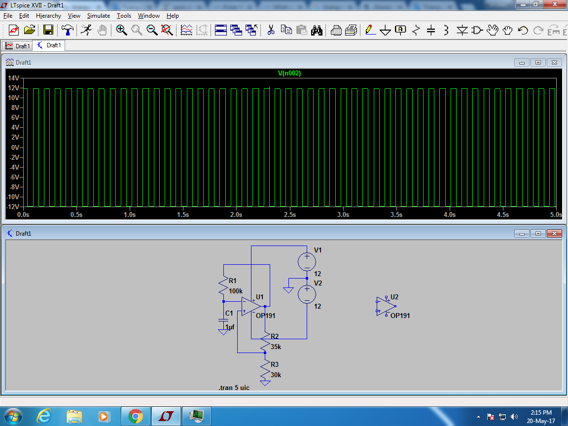

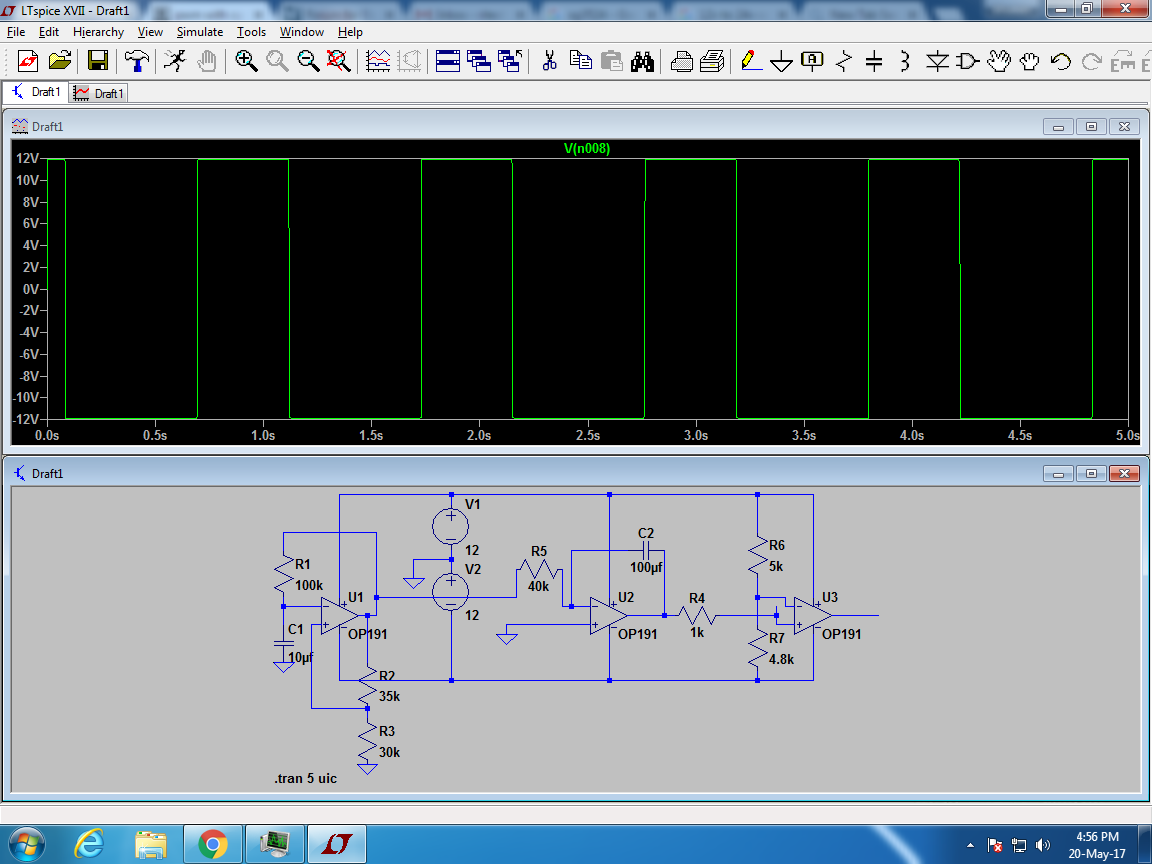

i have generated square wave what value chose for integrate opamp
Feed the triangle wave and a reference voltage to a comparator (another opamp can be used for that). The comparator output is pulses with a duty cycle determined by the reference voltage (which can be adjusted).
does it remain stable pwm
Yes, if the reference voltage and the triangle wave are both stable.
