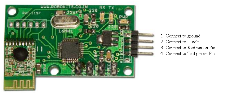

PWM from PIC16F877a....
Can't we do anything else then buying other serial module for now!!
only for sending 8 bits adresh result to another uC??
It it possible to use it for 8bit data transfer only 1 or 2 meters or should i buy tht serial 2.4Ghz link???
in this way the data is to be send??
The pattern of bits " 0 1 1 1 1 0 0 1 " encodes to " 01 10 10 10 10 01 01 10".
I have got these **broken link removed** as suggested by you for serial comm for sending adc result from uC to another ....
Did you download the manual!!!!!!
I did it was very easy..
OK, but that code need to be some changes for Tx and Rx...
for Tx example

Ok... One thing I want to ask..... Why are you messing with the ADC interrupts
	ADIF=0;
	ADIE=1;
	PEIE=1;
You are not using interrupts so there is no need to set them
This will confuse the issue..
The code needs a Hserin and Hserout routine. You also need to encapsulate the ADC routine...
Can you just give me a brief note on what controls what... Ie... control characters... Whats sent by the PC and what the micro returns..
OK, i am working on Wireless dc motor speed control using 877a
so, one uC will read the ADC and send this ADC result via UART then this ADC result will be received with another uC it will generate PWM according to it.( using that 2.4Ghz module i linked you)
