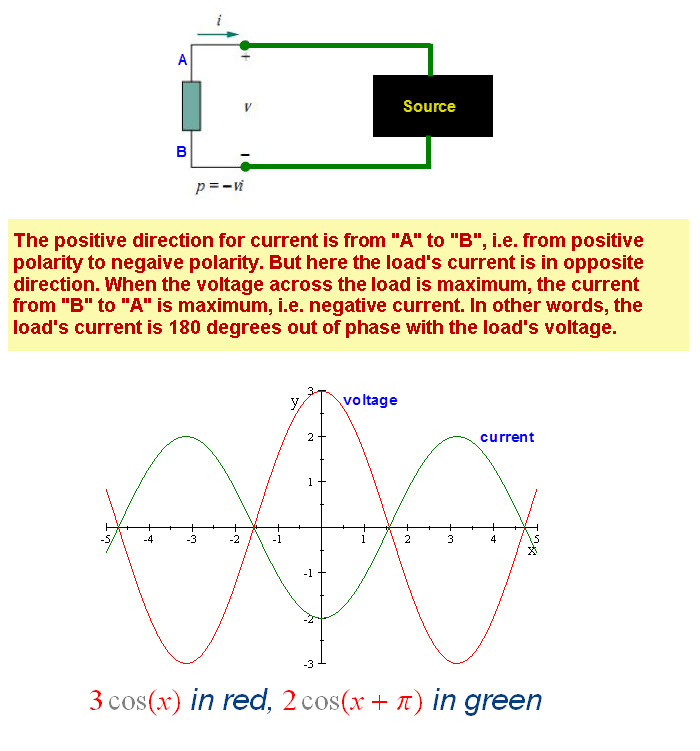

steveB said:
If somehow the load current was 180 degrees out of phase with the load voltage, then the source would be absorbing the power.
I kind of get your point and it seems this text is relevant here. This is what I make out of what you said.
But one thing really confuses me. In an ideal LC tank circuit if there are no resistive losses then the energy will keep on moving back and forth between the cap and inductor once the energy has been injected into the system. Suppose, there is an ac generator whose shaft can be rotated manually and to this generator a purely inductive load is connected. Cutting a long story short, from what you are saying I conclude that the generator can keep on rotating on its own because in one half cycle the generator is supplying power to the load and in the next half cycle the load is supplying power to the generator which makes the generator let rotating without any external input. I understand that what I'm saying is very close to the concept of perpetual motion machine but obviously here we are not discussing perpetual motion. Please help me with it. Thanks.

Thank you for your nice complement. I can't claim to be as good as you say, but I like that your questions are always aimed at true learning that leads to deeper understanding. This is the attitude that I respect very much, and it is the essential quality that I see in all good engineers and scientists of any experience level.
Essentially you have it correct. But, there are always losses in real engineering systems that we deal with. There is friction on the rotating shaft in the generator. There are resistive losses in the wires that form the coils in the generator, the coil and the circuit connections.

That's not quite correct, but this is a tricky thing to think about.
As you know, energy and power are different things, even though they are intimately related. The reactive power is basically the flow of stored energy, and the source needs to build up that energy during initial start-up transients. The dissipative real losses (resistance) represents a continuous power loss, while the reactive power flow is not lost.
