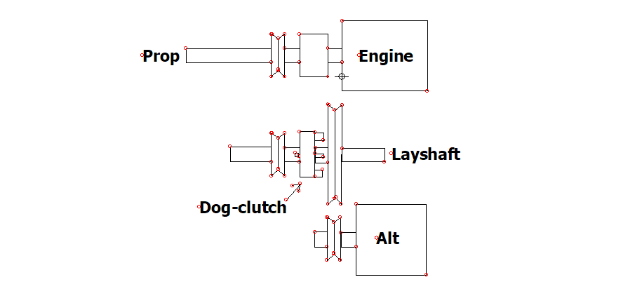

If it were me, I think I'd introduce a layshaft driven by a 1:1 ratio belt drive and supporting a home-brew dog-clutch which engages the big pulley, something like this :-
The layshaft speed would then be 2500rpm max and the big pulley would be idle when not required. I think a simple dog-clutch could be made from a disc keyed to and slidable on the layshaft. Pegs on the disc could engage holes in the big pulley, which would be freely rotatable on a bearing on the shaft.
Excuse the drawing: LTspice isn't the best of graphic editors :).
