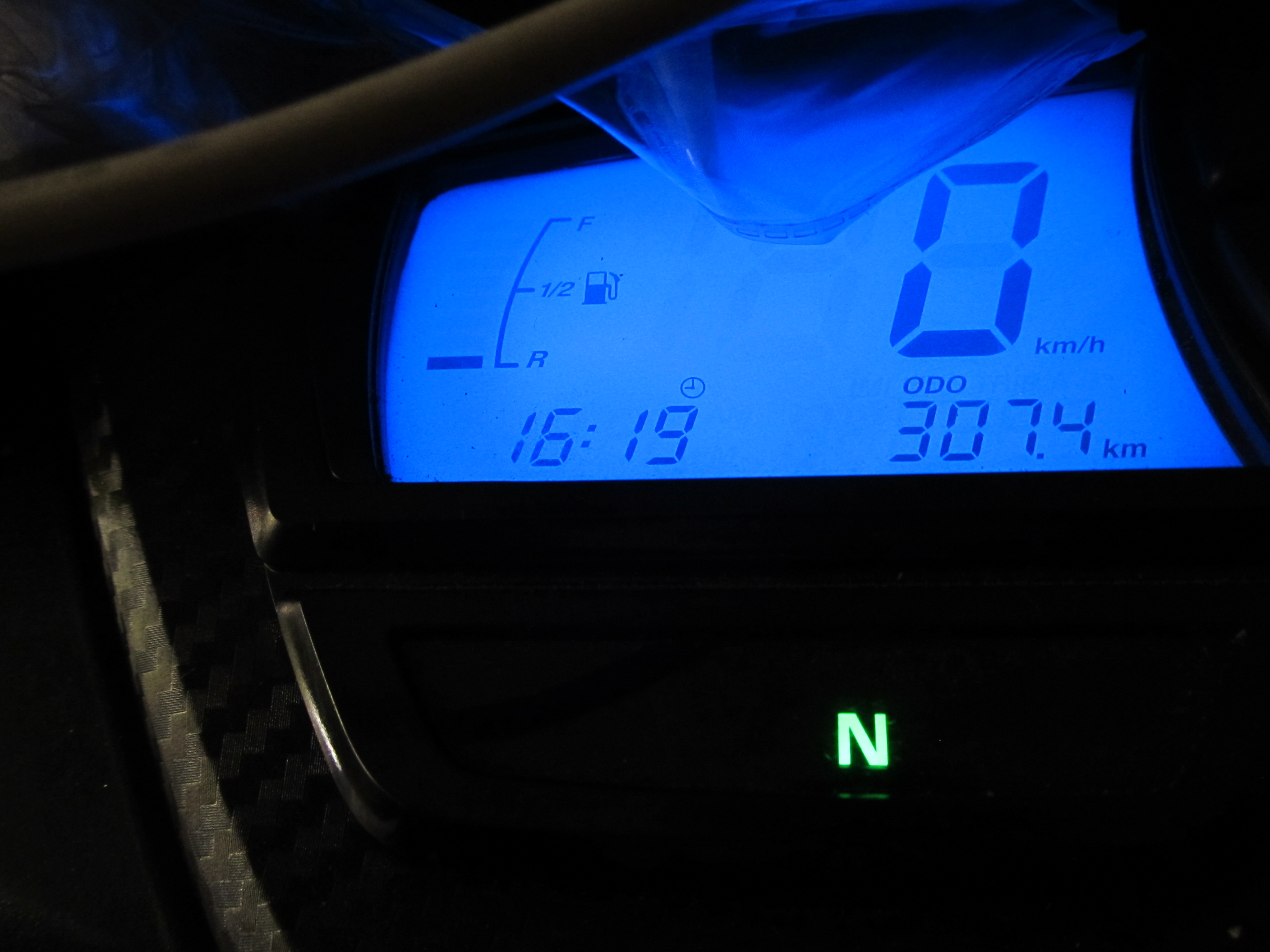

Recently I've acquired a motorcycle with a basic dashboard: Tachometer, Speedometer, Odometer, couple of warning lights, and neutral gear light. I'm not saying it's a bad panel, but I would like to make a better, customized one.
After studying maintenance manuals I found that all the signals are electrically fed into the panel, so there's potential to work with.

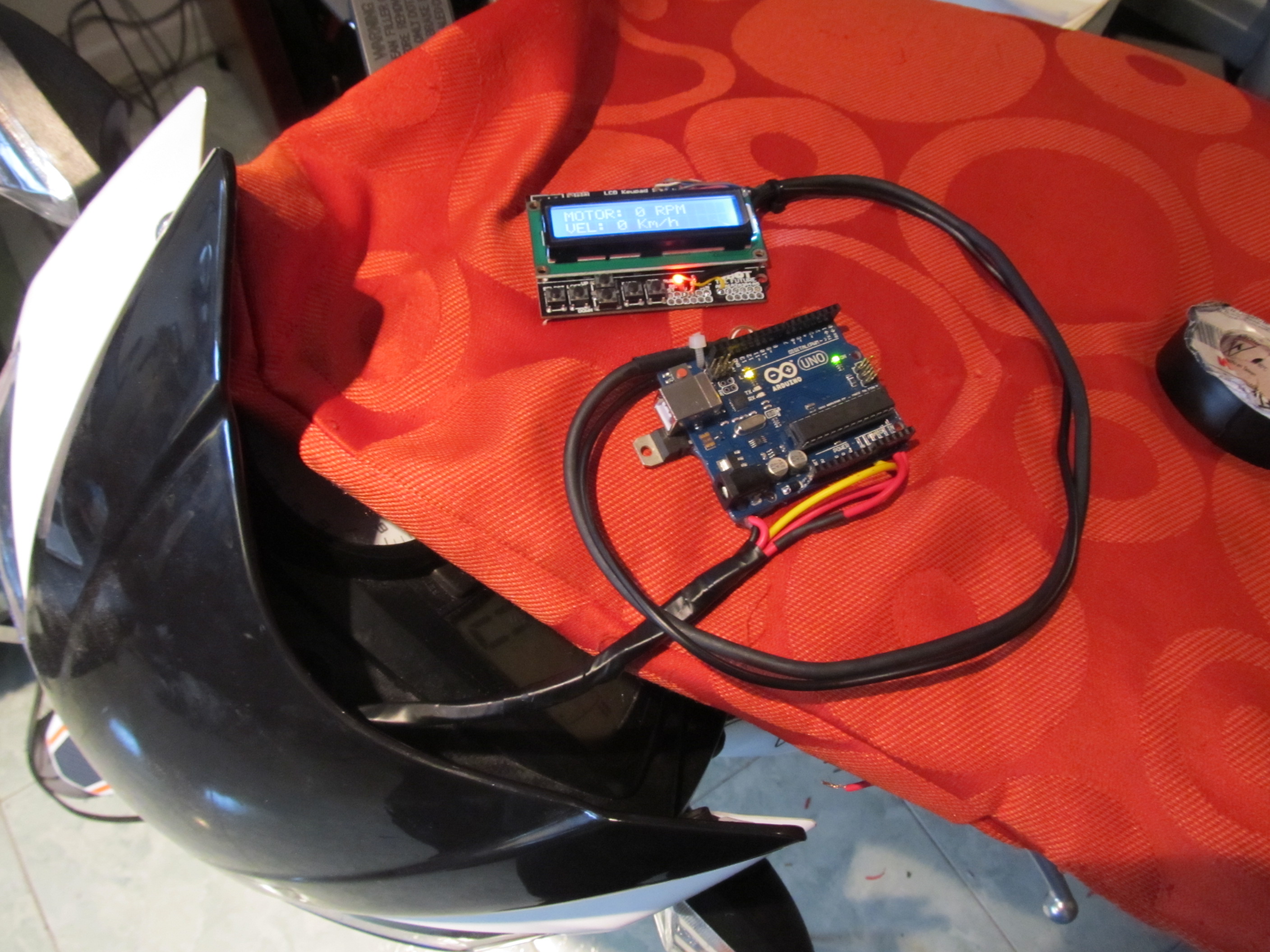

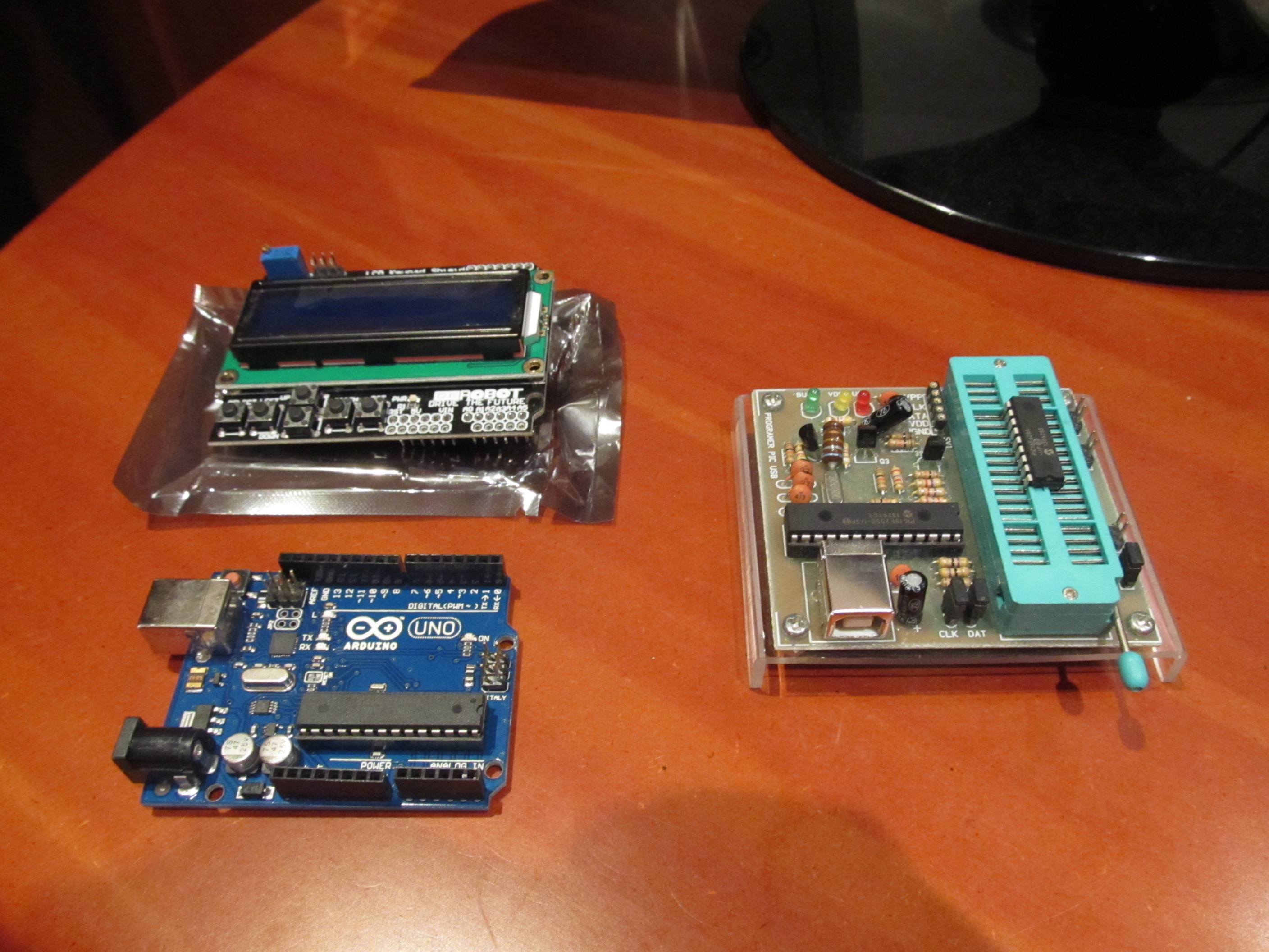

Well, things are getting serious now. Today I've received my Arduino Uno (suspectfully cheap, from a equally suspectfull seller) . I have also ordered a small LCD screen / menu push-buttons combo to communicate it with the outside world. The screen is great, but it occupies all the Arduino's analog pins . I have no idea where I am going to wire the tachometer, speedometer, fuel gauge and the other signals :facepalm: but let's solve that little problem later.
By the way, on the right side of the picture is my beloved Pickit 2 clone, armed with a virgin PIC16F628A. I bought it some months ago but never used it. I asked multiple people about what's the best software to start programming it. A couple of engineers at my work told me that PIC was very outdated and better, easier platforms are available today. Meh! I don't believe too much on them. If you can give me some hints (and hence drag me away from the Arduino's Dark Side!) it would be great.

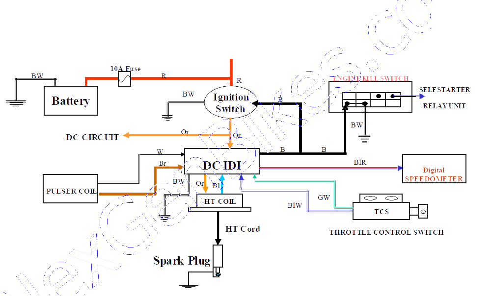

TACHOMETER:
According to the service manual, the signal for the dashboard comes directly from the ignition circuit. I think is incorrectly labelled as speedometer, as I can't see any relation between the ignition circuit and the speedo. Not even inhibiting it, because speedo still works with the engine off.

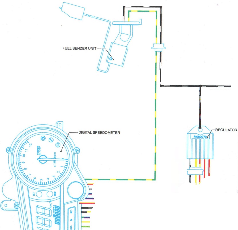

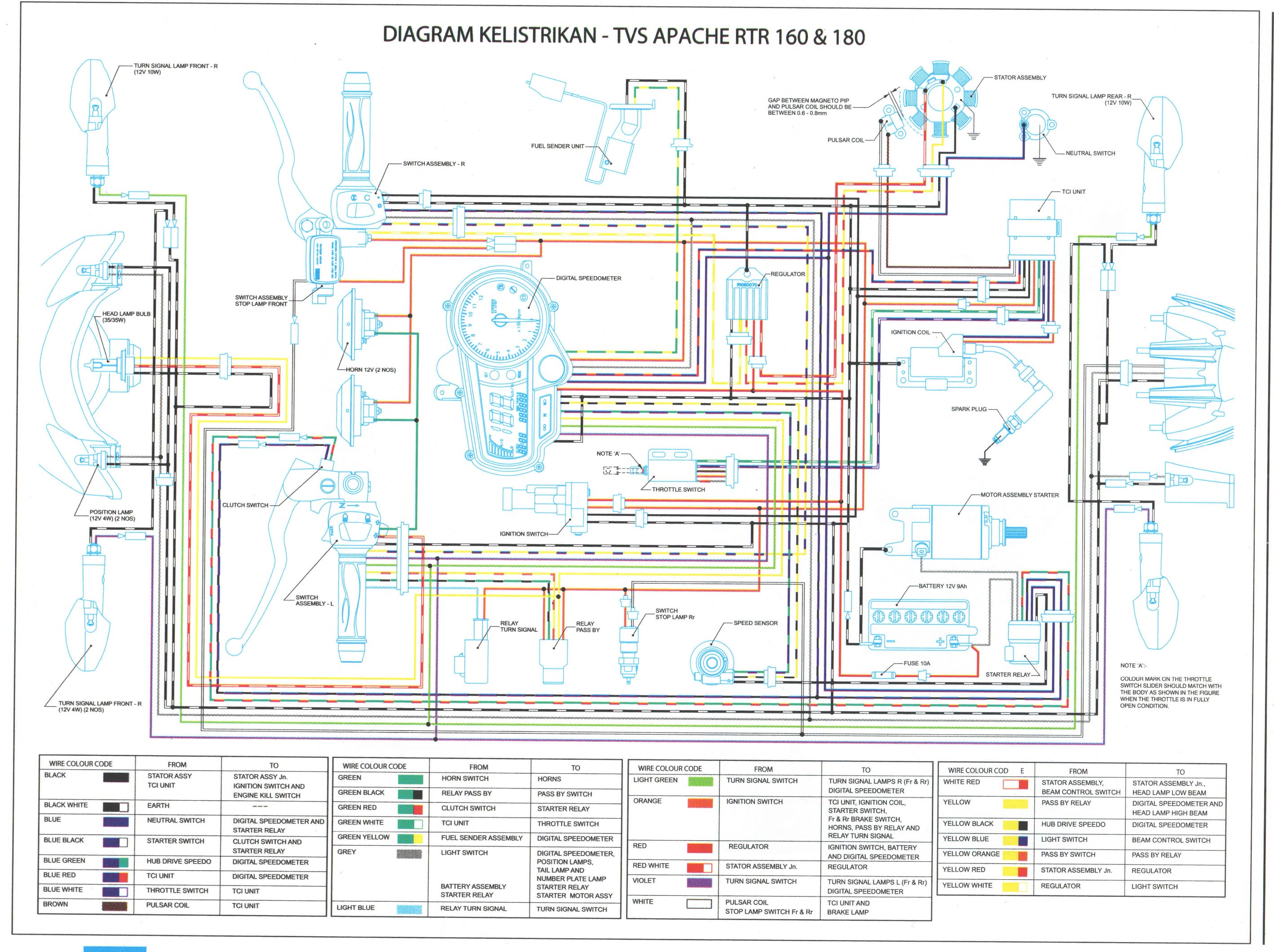

I think I nailed the tachometer and fuel gauge signal thanks to this very good diagram.
However, in the case of the speed sensor I don't know what kind of signal should I expect from the 3 wire device. One of the terminals goes to ground, and the other two go to the dashboard.
Do you have any experience with this type of sensor? What is is? A commutator? a hall effect switch? If you could give me some light before I start poking the wires, I will really appreciate it.

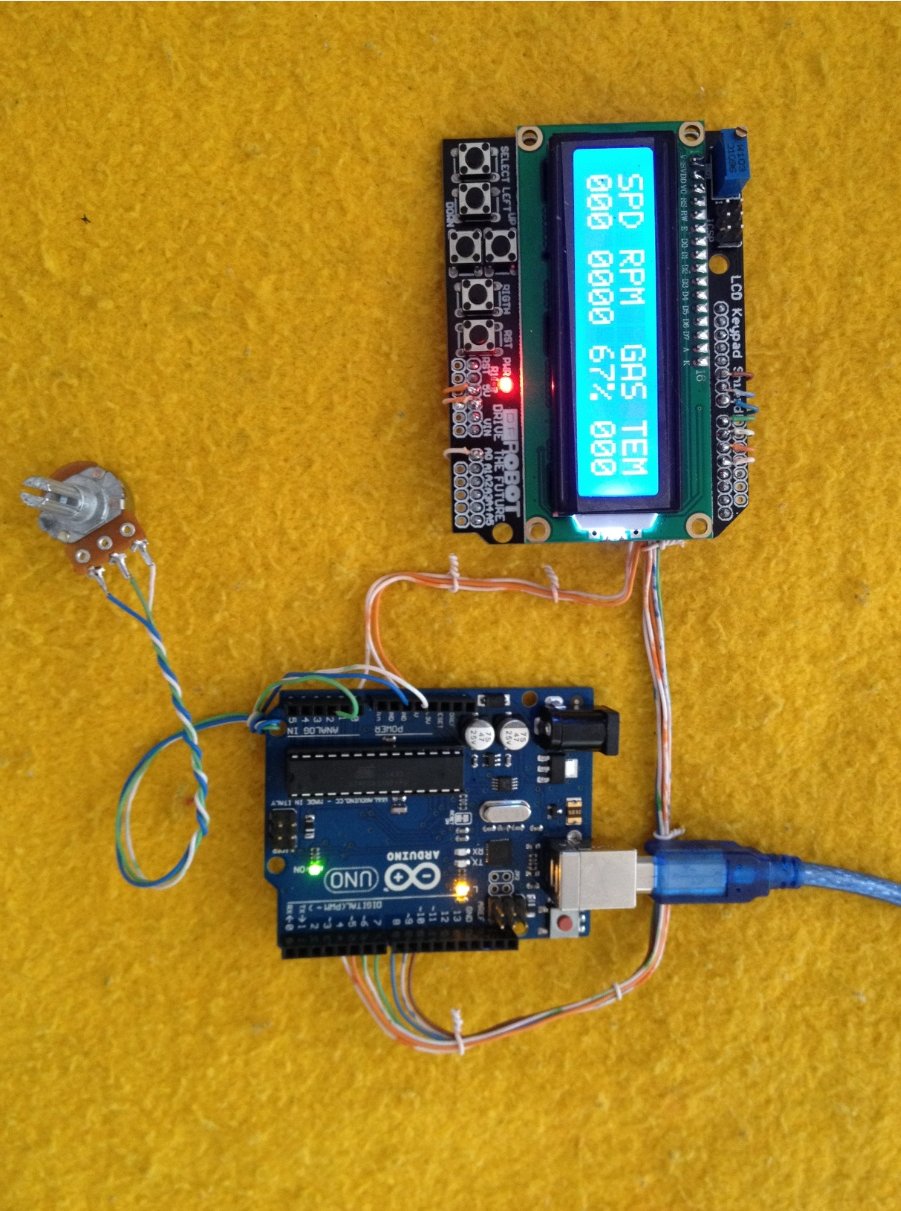

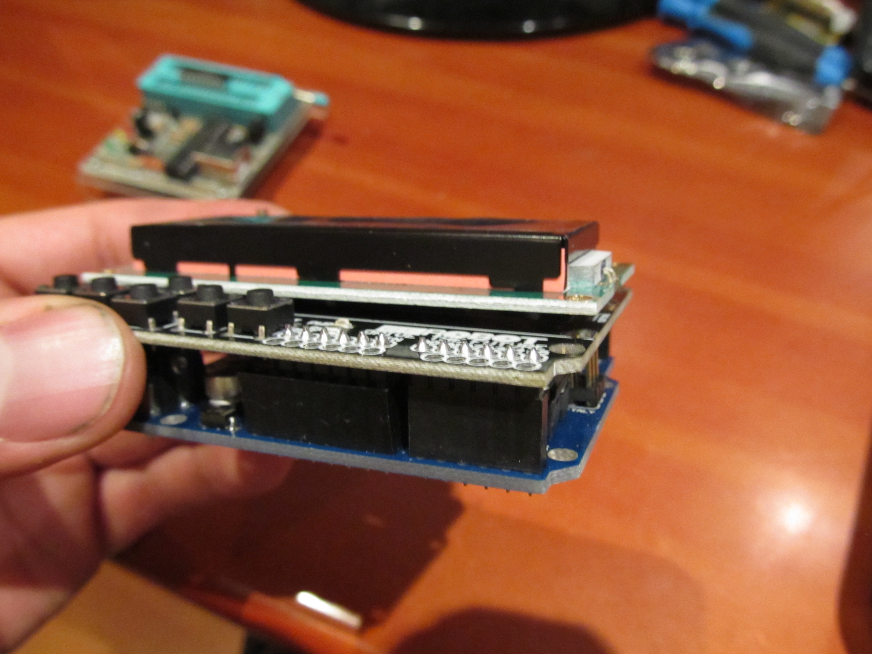

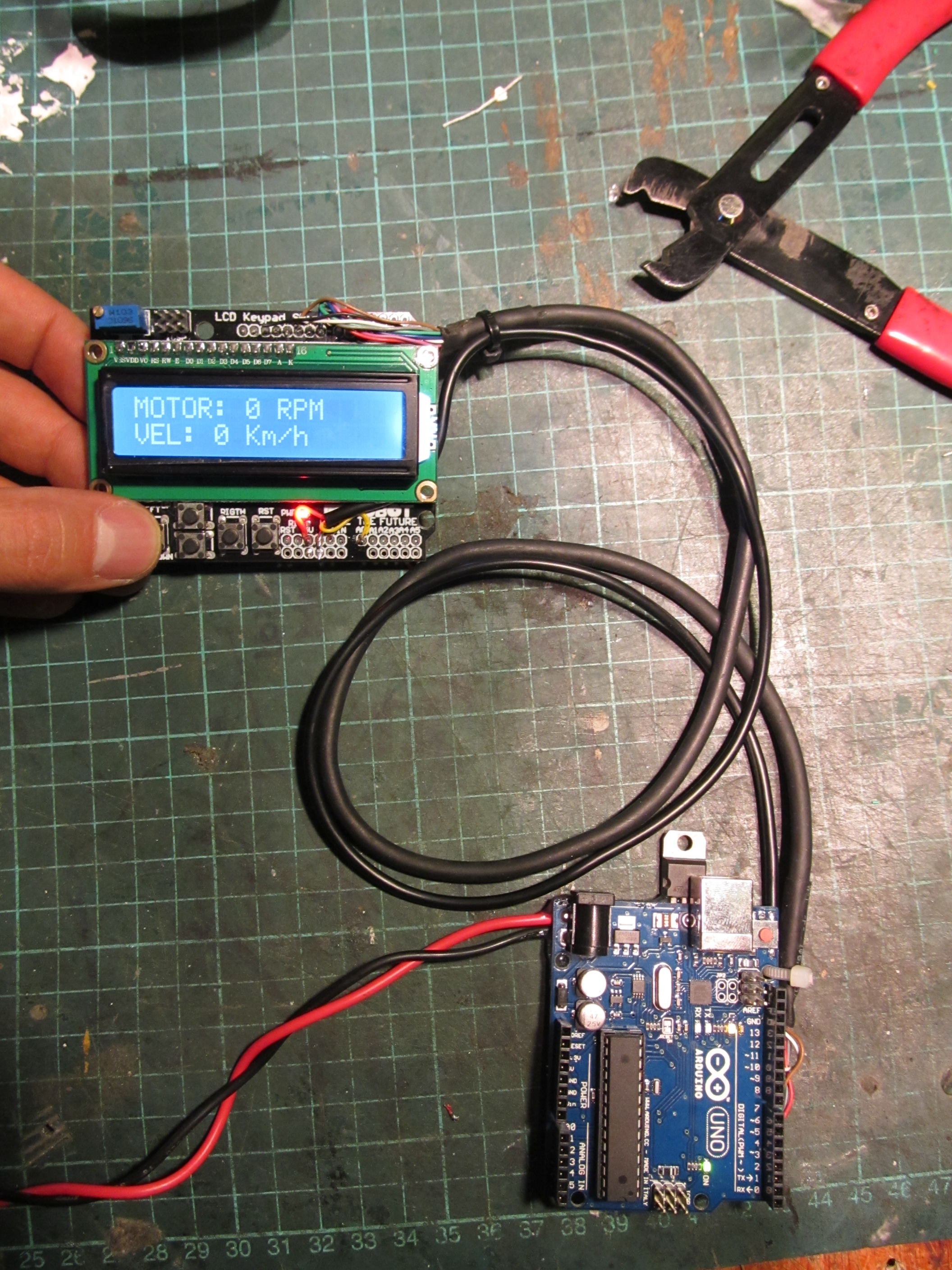

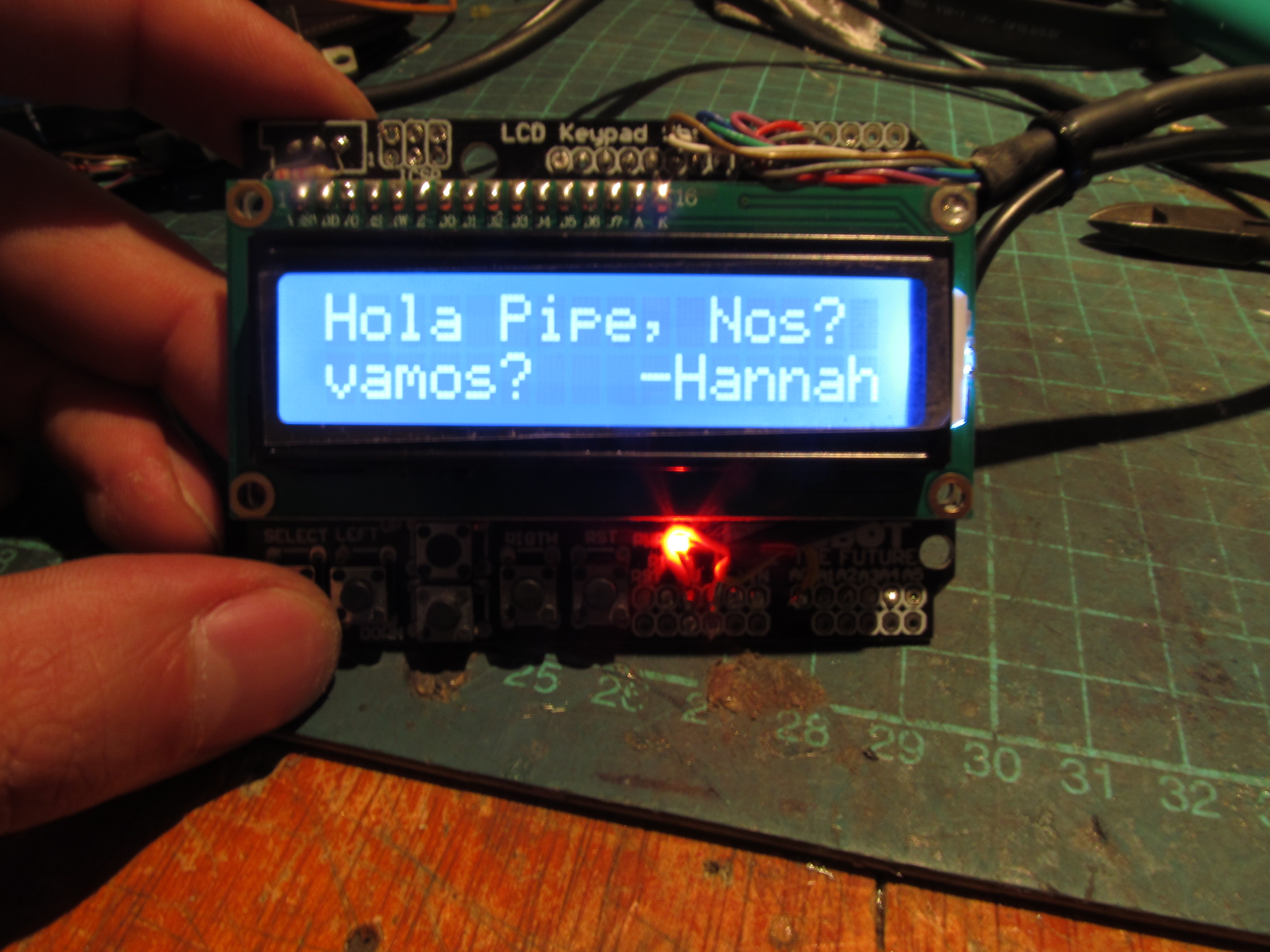

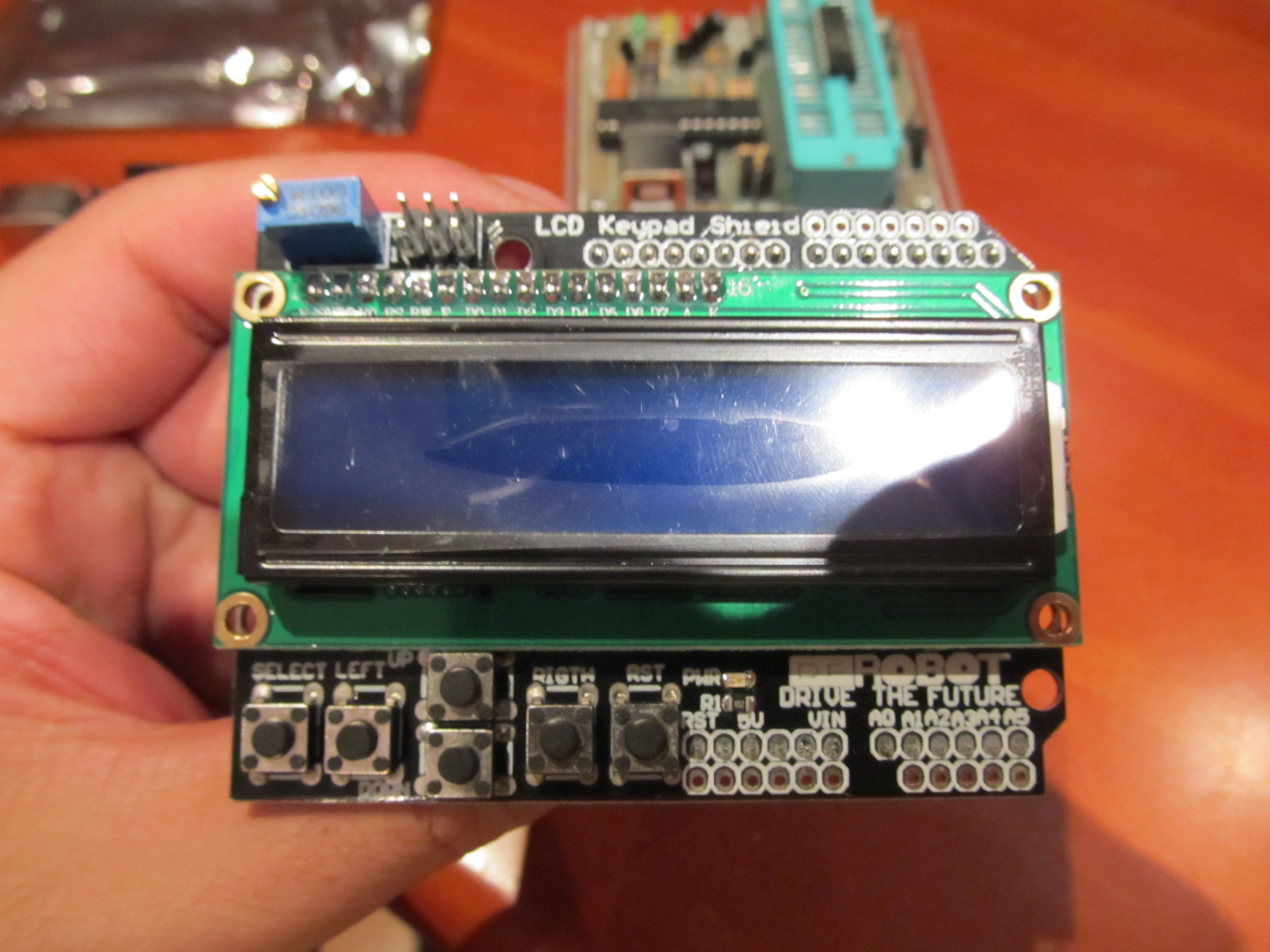

First thing on the list was the LCD occupying all the free pins. I checked the link that you suggested to buy another one, but importing stuff to Colombia during this time of year is a nightmare. Luckily I found that my existing LCD just took the pins as mechanical support, and are not electrically connected. (Edit: My LCD looks like a rip-off and hence it doesn't include the extensions found on the original dfrobot LCD keypad shield)
The solution was hence very easy, just extending pins 5-11. I wrote a small program to show the needed stuff "Speed, RPM, Fuel and Temp" and the Arduino was ready to test.

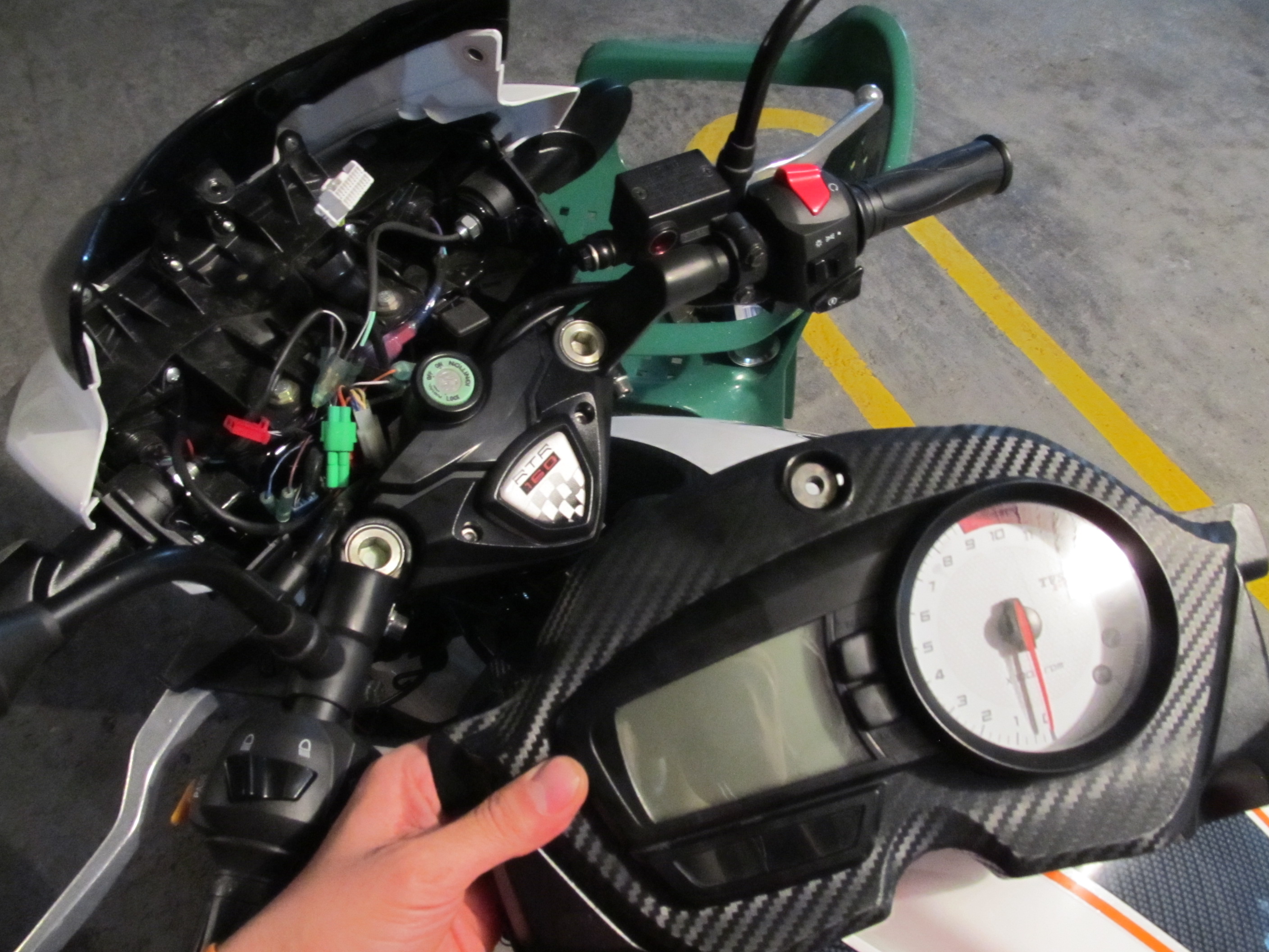

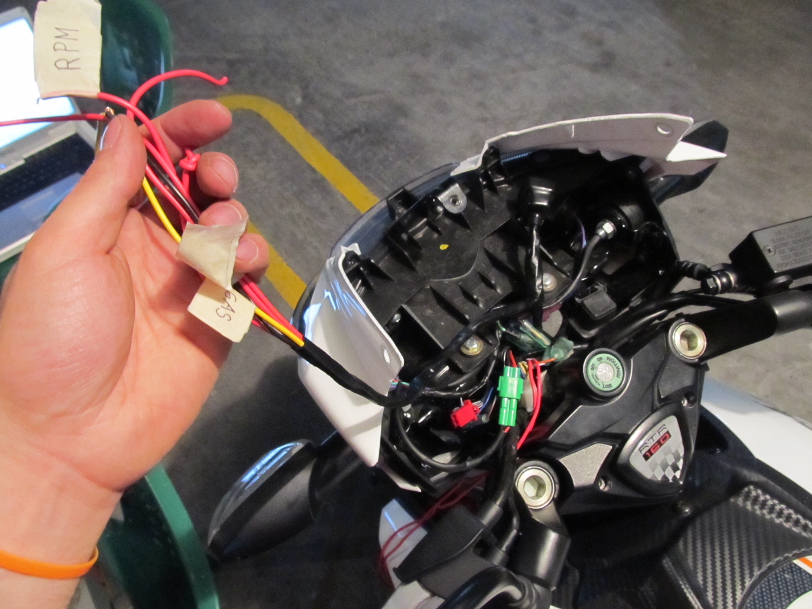

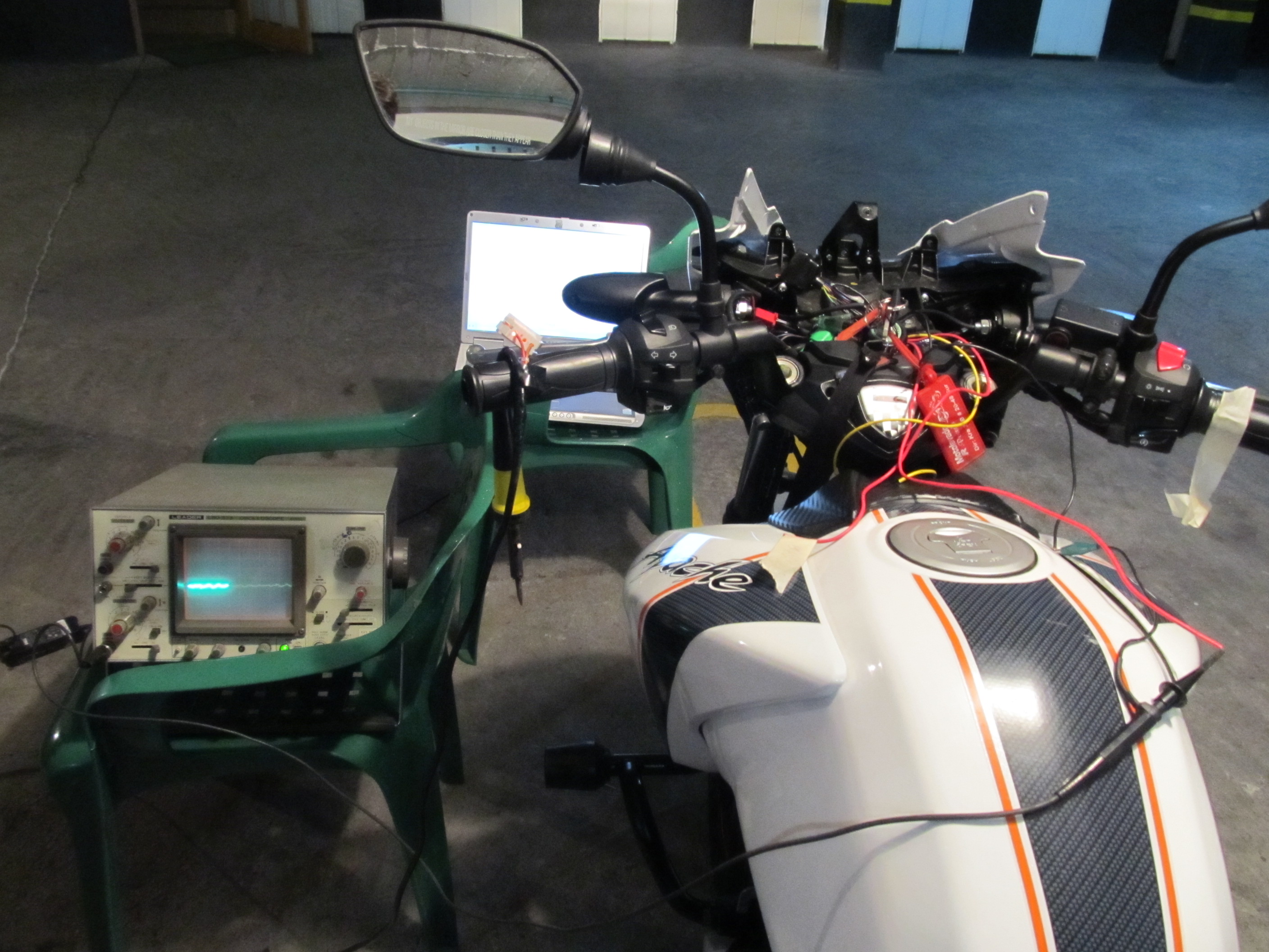

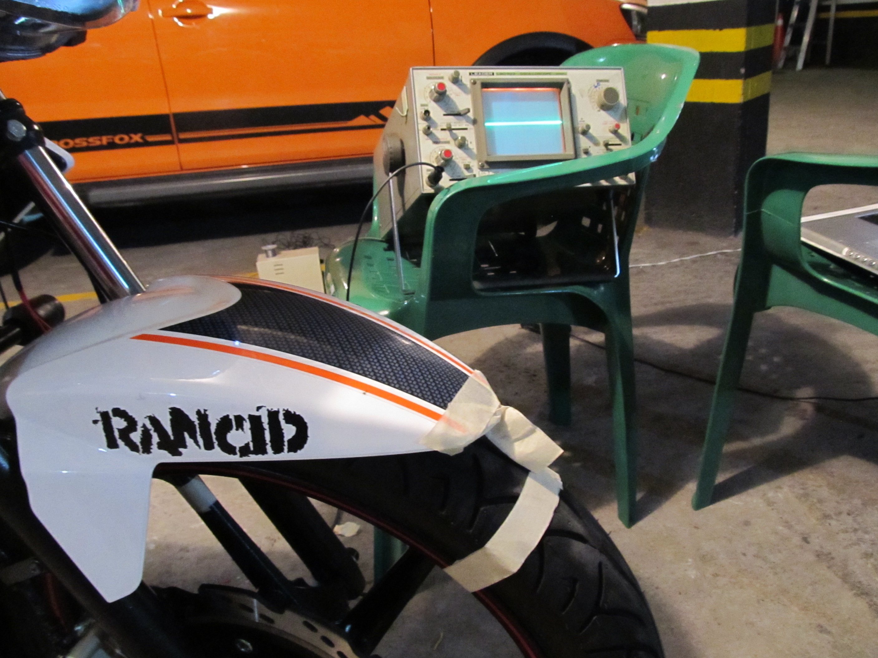

Second step was getting the signals. The best site to intercept the wiring harness was the existing dashboard. An ice tray cube is very useful to keep track of where the screws came for.
Some colors of the harness didn't match the schematic that I found (included on previous post) so I had to find the signals by hand.
I've added a new wire harness for the Arduino and temporarily reinstalled the panel.
Now Speaking of signals, this is what I found:
Speedometer: Your guess is correct Clyde, the Sensor is feed with +5v and 0v coming from the dashboard. The signal fluctuates from 0v to 5v when the wheel is spinning forward and vice versa. The method to determine the number of pulses per wheel revolution was somewhat archaic but worked: exactly 8.
RPM:
The signal comes from the TCI engine unit. It was somewhat proportional to the RPM shown on the dashboard, but I couldn't find the exact proportion because the frequency varied wildly even when the engine RPM were constant. For example: Tachometer: 1200 RPM, Signal: 150-350 Hz. Probably instrument error, I used my multimeter cheap frequency counter. Maybe I need some filtering? Please, Any ideas here are welcome.
FUEL GAUGUE:
Is a variable resistor, the value ranges on tens of ohms. It shows error under fully open and closed circuit conditions.
But here's my second and biggest intrigue. On the Arduino example, they use a voltage divider between 5 and 0 volts. Works great.
But the fuel sensor is just a resistor shorted to ground
I though about using a known-value resistor shorted to +5v to create my own voltage divider for the arduino. But I'm afraid that this may damage the existing dashboard indicator when the variable resistor value gets too low. What do you think?

I nailed it! And you were right (again)
First step was measuring the sensor wires, it showed no voltage whatsoever. That confirmed that the sensor was shorted to ground.
Then I tried to trick the dashboard with a trimmer potentiometer to see what resistance values it would respond to. I failed because the resistance between "Full tank" and "Closed circuit Error" was too small, smaller than any potentiometer on my bench at least.
Tired of an hour fighting with the sensor, I just rode the bike to spend the last bit of remaining fuel and took the resistance measurement.
Next step was finding an appropriate resistor to build a new voltage divider. My worries were overheating the tank sensor, or changing the value displayed on the OEM dashboard.
Then I remembered your comment and it was like a self-kick in the ass!!!
I’m sure you realize, but that pull up resistor shouldn't pass enough current to get the tank sender hot.
No, I didn't realized that! :facepalm: An even more: a new voltage divider isn't required at all, because there should be an existing pull up resistor already installed for the OEM sensor!!
I just connected the Arduino analog input in series with the existing sensor, and it worked flawlessly. Thanks Clyde.

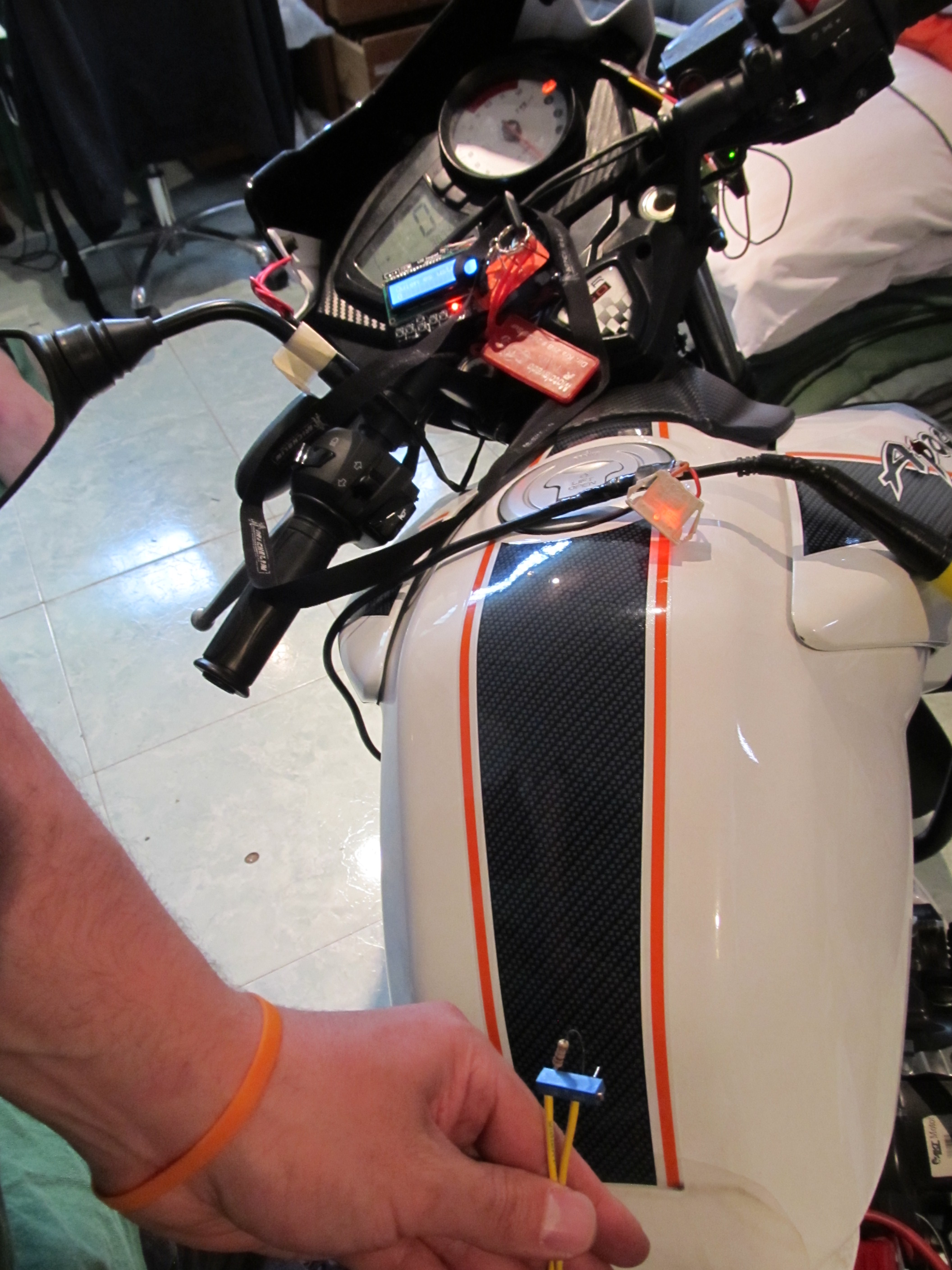

Recovering from my shame, I proceeded to install an LM7805 voltage regulator and decent automotivewiring.

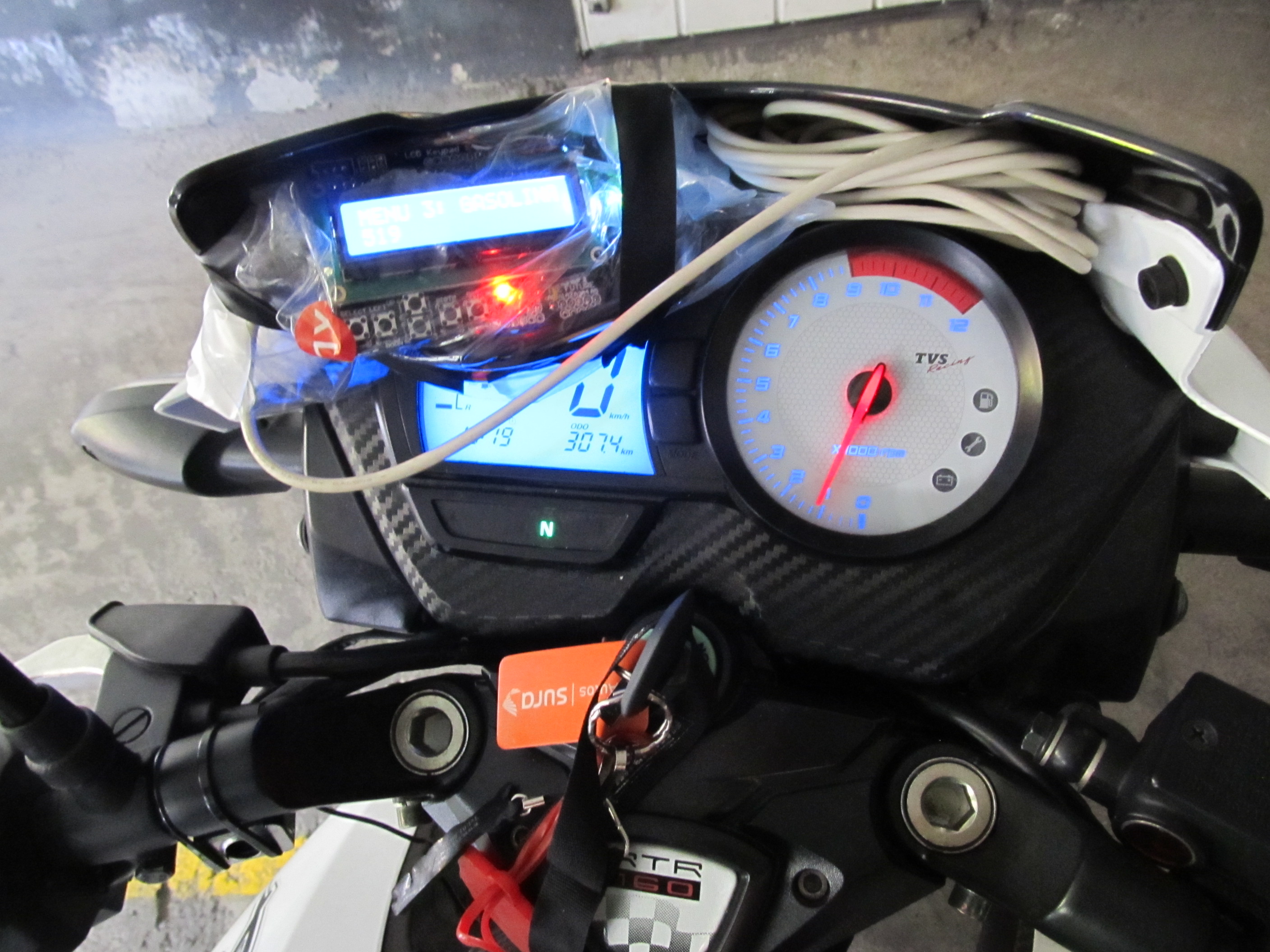

Then it was time to prepare the computer for its first ride
All the measurements were coherent. The DIY speedometer and Tachometer are more accurate than the OEM dashboard!

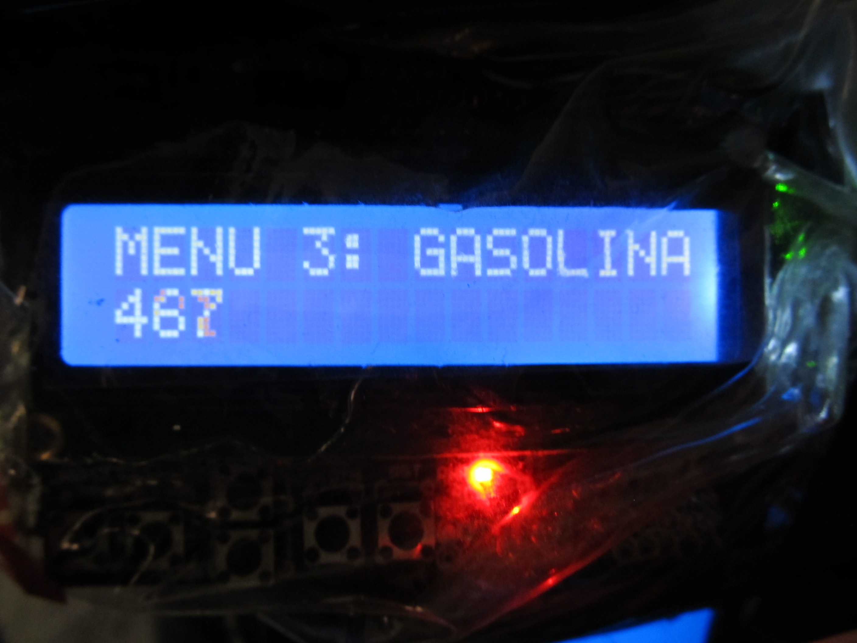

Now I have raw data to work with! While I write this post I'm programming the consumed Fuel Gallons vs.Km and hence Autonomy calculations.
