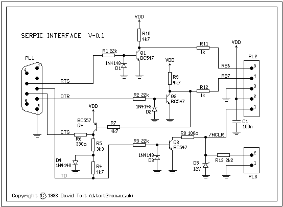

I started my mcu adventure with PIC16F84 , you can build a simple DIY programmer and use
https://www.cs.ucr.edu/~eblock/pages/pictools/fpp.html
that will download a hex file to this device, are you after assembler code...
Its Old stuff ( like me) but so is that PIC...
It could be also programmed with a Picstart Plus programmer. Sure is dated but lot of people still use it.
