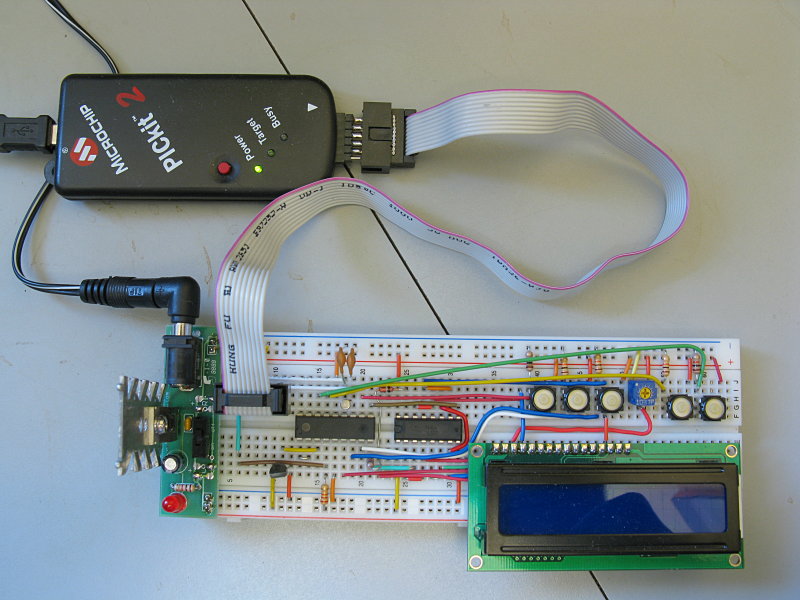

Just use a **broken link removed**. Simple, inexpensive and flexible. Excellent for experimenting and prototyping. For lots of photos and examples, have a look at my site.
This one is getting a tad crowded. :D I have bigger ones...

I have a breadboard already...just briefly do you have a circuit diagram of what pins I attach to what?
I see in one of your photo's you have resistors and capacitors across the values from the pin as well....its just a bit hard to see what pin number from the PICkit 2 kit goes to what terminals on the PIC chip.
I suppose P6 goes to Vdd for starters.

Looking at the PICkit 2 from the top side, starting at the arrow (pin 1):
1. VPP - goes to MCLR (don't forget a 10K to 33K pullup resistor on MCLR)
2. 5V - goes to VDD
3. GND - ground
4. PGD - to PGD pin on the PIC
5. PGC - to PGC pin on the PIC
6. Not used
Fantastic - thanks heaps. I think I will go out and buy a 16F887 now :)
Sorry about P6....I saw a little P1 beside the right most pin, I assumed that was Pin 1. You've put me right though.
