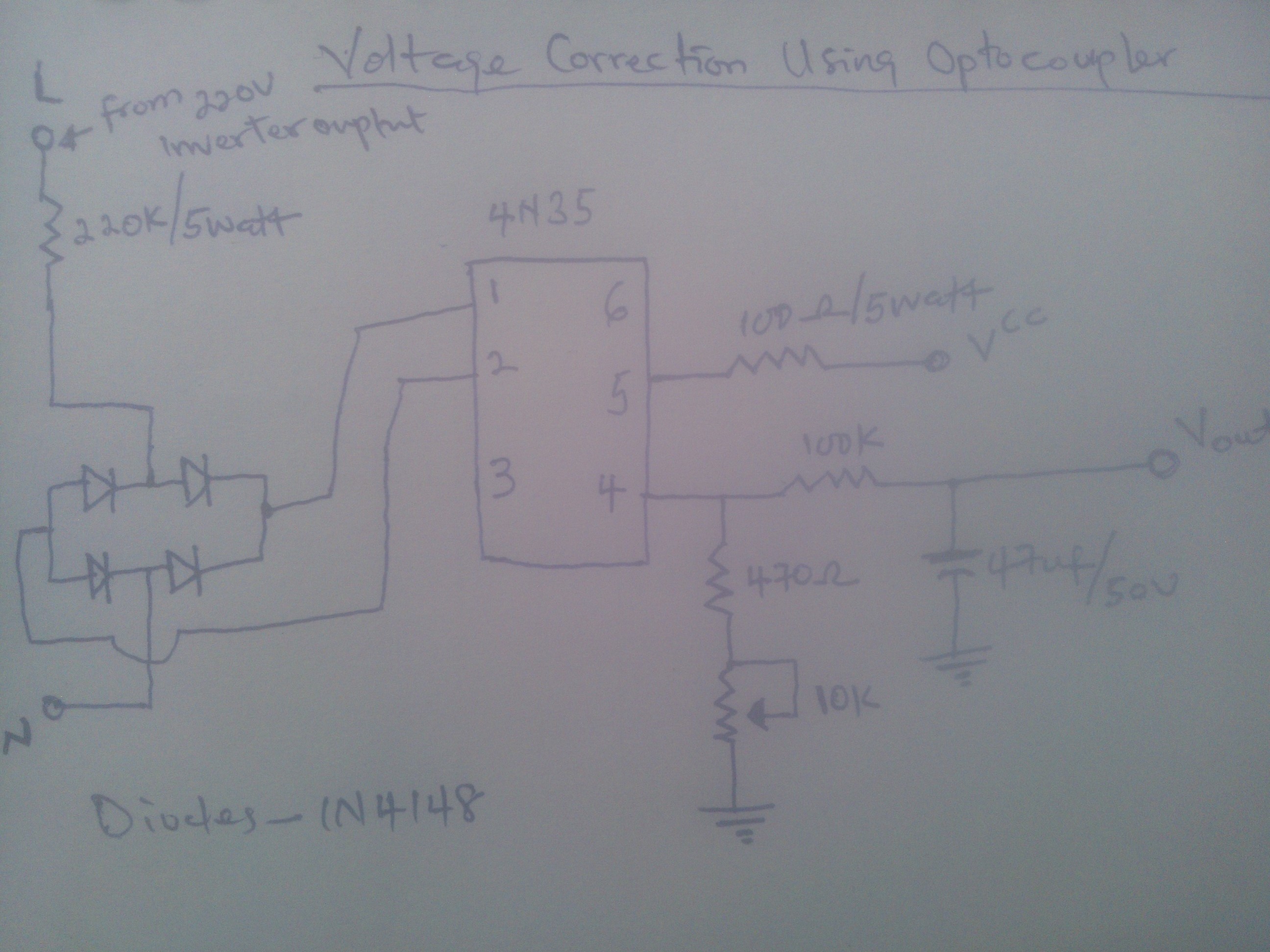

hello,
i want to ask your opinion about this configuration which i intend to use as part of the feedback system to maintain steady output voltage.
the diagram uses a 4N35 optocoupler and from the diagram Vout will be connected to the input of an error amplifier which already has a reference voltage already and from there duty cycle will be duly adjusted as per needed.
i am trying to eliminate the need to use a small feedback trafo as i want to reduce amount of components.
what do you guys think?
I think if you connect the bridge rectifier direction to the 220vac output then the diodes forward drops have less influence on the voltage measurement.
That would put the 220k resistor on the DC side of the bridge rect.
Also consider that with 1ma input you only get about 0.7ma output, so the resistor values on the output probably have to be increased.
Also, LED efficiency drops with age, meaning less light output over time, and it is somewhat exponentially related to the drive current. So the lower the current the better the aging is so the more stable the output voltage will be over long time periods like years. I would think 1ma should be ok though, but it depends on the max current of the LED. One tenth the max current should be ok.
Hello Sir,
1)Basically the 220k resistor should be between pin 1 of the 4N35 and the postive DC voltage output after rectification so that voltage measurement would be as accurate as possible?
2)it is also possible that i can choose to increase the 220k resistor to a higher value so as to reduce the input current based on your explanation about the drive current.i will try to study the datasheet again anyway.
could you elaborate here better please?
also what actual resistors at the output would have to be increased?

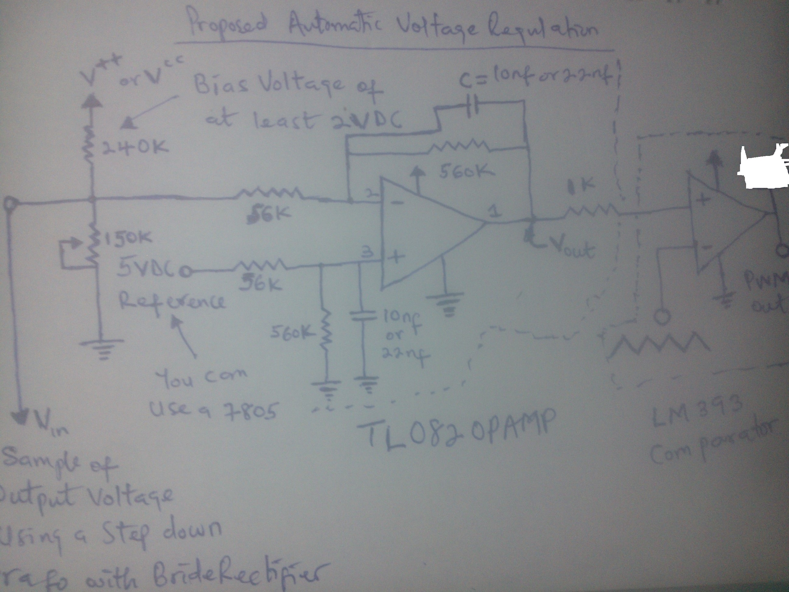

here is an error amplifier constructed to work with the proposed 4N35 optocoupler circuit.
The TL082 is set up as an error amplifier with a steady 5v reference.
the inverting input is biased but this was done so that even without voltage correction i can still manually control output voltage.
Vin receives sample of output voltage from 4N35 output added to the biased voltage and the error amp does the rest.
what are your opinions?
You do not want to rectify the feedback signal which will squash the peaks reducing the amplitude of the sinewave and its filter will act very slowly.
Instead you want the feedback signal to be a sinewave that adds to or subtracts from the original 50Hz sinewave that feeds the comparator.
Then it will regulate the output voltage immediately without distortion.

Well i was actually wondering why you have a 100 ohm 5 watt resistor at the output of the opto coupler.
I see now you also have a 10k pot with the 470 ohm resistor so that might be ok.
Also, why a 5 watt for the 220k?
With 1ma input to the opto coupler LED, the output current will be around 0.7ma roughly, which is 70 percent of the 1ma input. That 0.7ma has to drive the next stage.
I guess you intend to drive the error amplifier with that signal?
Where is that triangle wave coming from, what is that for? Is that for regular PWM?
It is nice that you are providing drawings now, but i think it would be better if you could get better scans as the pictures lack contrast so are harder to read. Maybe more lighting would help there if you use a camera.
hello audioguru,
pls i am a bit lost here as to what you are trying to say.could you elaborate a bit better please.Thanks
You are making a PWM sinewave inverter with a 50Hz Bubba sinewave compared to a high frequency triangle wave.
Add a new opamp with the Bubba sinewave on its (+) input and you attenuate the output of the inverter and use it as negative feedback to the (-) input of this new opamp. The output of this new opamp becomes the sinewave input on the comparator.
If the inverter output sinewave has a low amplitude then the negative feedback will increase the level of this new sinewave. If the inverter output sinewave has an amplitude too high then the negative feedback will decrease the level of this new sinewave.
Because the inverter output is filtered then the output of the Bubba oscillator needs the same filter so that their phases match.
