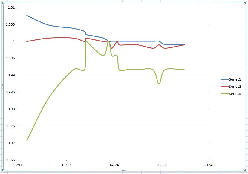

As you have got the program set up, any chance you could post a composite plot of series1 and 2 ie: PTX water and PTX air combined.?
Eric
EDIT: algebraically of course.:)
Now that I have had some sleep, here is my graph:
The time of day is on the X axis.
The 50m PTX is the blue trace
The external PTX is the red trace
The temperature TX is the yukky green trace.
All values have been normallised to "per unit", of the values at 14:15.
Thank you very much Jim. Unable to conclude anything. I will repeat my experiments once my set up is ready. Will try to conclude whether this sensor can be used or I have to go for something better.
I would conclude that there is no definite correlation between the three series of data, within the limits of measurement accuracy.
I speculate that the apparently consistent drop in the water pressure sensor readings might be due to some gradual 'settling-in' process, e.g. a permanent slight deformation of some part of the sensor. Repeating the measurements, over a longer time period, might help to prove/disprove that theory.

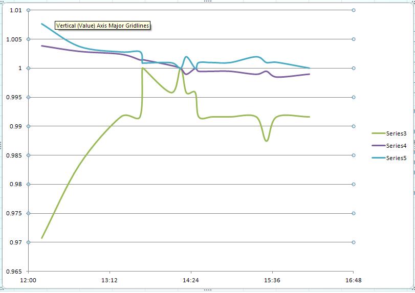

Eric, you are a hard taskmaster!
Here it is:
Again, the traces are:
Yukky green - Temperature
Purple - (50m+ext)/2
Light Blue - (50m - ext +1)
and your conclusion is?

What, not even that they make big jumps up and down at the same time?
Not even then. Meter accuracy is 0.5% + 3 digits. Besides, some jumps up coincide with other jumps down.
"5" has to be. Just has to be the answer.
That aside.
Note that the inflection points all generally-coincide. Temperature or turn-on/turn-off spike co-incident with the air conditioning turning on and off?
maybe a power dip to AC also caused supply issue to sensors. in addition to RF noise and temp shift . All easily solvable problems.
The % difference is well within the range of what might be considered barometric pressure.
So,in the absence of anything else, I'd say poor power supply regulation and that it reads absolute rather than gauge pressure. The shape also suggests barometric pressures.
The water and air sensors "track" somewhat shape wise suggest barometric pressure.
The meter suggests that you don't have enough accuracy to resolve the height resolution required. I would "think" that a 4-20 mA sensor that reads in gauge pressure and has a port to the air atmosphere is required.
4-20 mA allows the sensor to be powered by the same lines used for readout and the lines can be arbitrarily long.
Powering a sensor with a constant voltage supply over long distances, there is a voltage drop across the leads and the measurement usually has to be differential.
