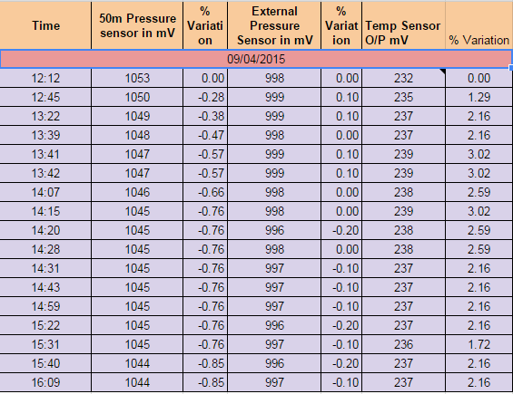

I had the temperature sensor readings also .If you see any anomalies , I will arrange the readings again. The Air Conditioner in the room was intermittently switched ON and OFF. My work place is shifted and it may take some more time to fix this set up as the new place doesn't have sufficient height (due to false ceiling) to fix the pipe.:)

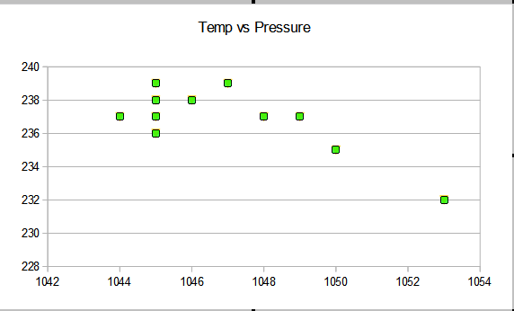

Prem, if you have this data in Excel, try plotting the values on a graph.
It looks quite interesting, I am not sure what it proves but I think it is interesting.

AS it turned out that only took me a few minutes Temperature Correlation is indeed useful for improving the accuracy.
There is obviously other sources of error below 1047, but above 1047, the correction factor is a linear relation.

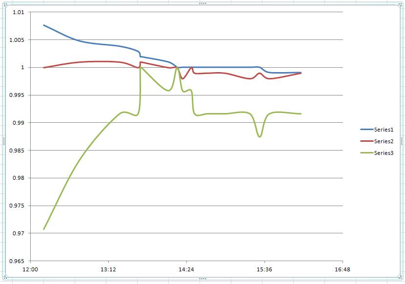

Now that I have had some sleep, here is my graph:
The time of day is on the X axis.
The 50m PTX is the blue trace
The external PTX is the red trace
The temperature TX is the yukky green trace.
All values have been normallised to "per unit", of the values at 14:15.
