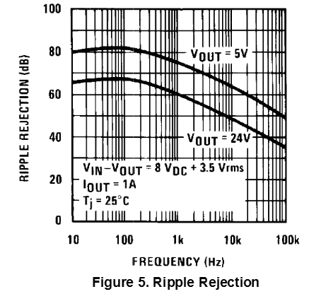

    I have purchased a (Chinese) 12VDC 20A power supply from eBay.
    One of these
    http://www.ebay.com/itm/DC-Power-Su...2A-15A-20A-30A-Plug-Pigtail-lot-/401103056399
    I don't have an oscilloscope to see how bad the voltage regulation and noise output is. I presume for the price, pretty bad. BUT if the power supply is used to "convert" 120 VAC to 12VDC (as it does) and the 12VDC is then used to drive a linear step down voltage chip (such as a 7805, NCP1117, or similar). Would the poor regulation and/or noise be passed to the output of the second stage and the final voltage?

    From datasheet.
    If the 12 volts varied from 12V to 13V the output of 5 volts will change 0.01% max.
    If your load changed 1A the output voltage will change by 0.3% max. (100mA load change = 0.03%)
    120hz noise (60hz) will be reduced by 80db.
    Noise on your 12V will be reduced by xdb as shown. This is dependent on capacitors and type of caps.

    I woudl just add some capacitors, (less than the amount which will make the psu go unstabl) unless its a really sensitive app like a radio receiver receiving a weak satellite signal.
    Ive had so many cases of micro's not working because of "psu noise", which ended up being faulty software, or floating input pins on the micro, etc.

    In fact, dont even bother adding caps, as there will be enough output caps in the output of the psu.
    Another point is that adding a linear reg to the output wont do anything to help common mode noise.

    Bear in mind, dropping 7 volts across a 7805 will generate a lot of heat.

    And I was only pointing out that if you think you're going draw an amp at 5 volts for example, you will be dissipating 7 watts in the regulator.
