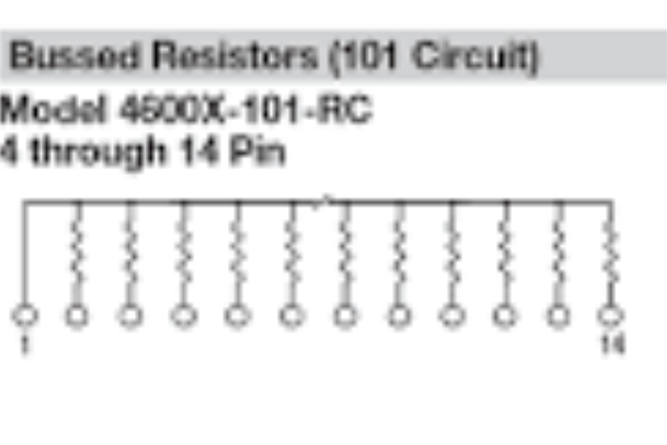

I have used Elecrow to build boards twice, once for 25 pieces of 2 different boards with mostly through hole parts and once for 60 pieces of a small SMT board with 6 chips, mostly fine-pitch MSOP and similar parts.
In both cases, I've been pleased with the results although everything wasn't perfect. For the first set of boards, the located a supplier for yellow 7-segment digits when they couldn't get any from their usual sources. They are holding the balance for me when I need another batch - the minimum order quantity was far more pieces than I needed, but it was cheaper that way then sending parts from the US.
That first batch of boards had every SIP resistor installed backwards - don't assume that everybody understands the index mark on the SIP goes next to the mark on the board. This problem was easily fixed.
The second batch of boards fell victim to fake Linear Technology chips. I don't fault Elecrow for this - the chips look like the real thing. I returned the lot of boards with known-good parts and they repaired them at no cost.
My advice is to spell out the details. Include pictures and illustrations any place there's a chance for error. They will spend pictures of the first assembled board - check the details carefully.

The resistors are coonected to a common pin, which is indicated by the dot on the package. If it's reversed instead of all the resistors being pullups, they acted more like a voltage divider.
