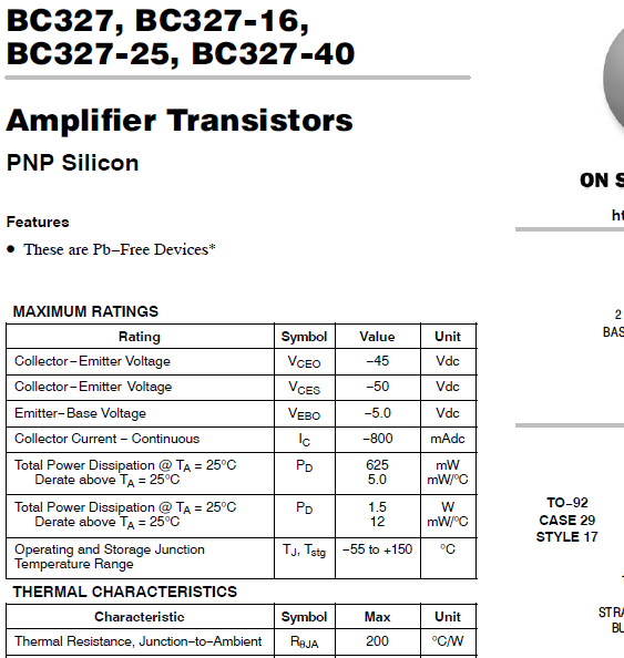

BC327 would be another replacement.
The above covers functionality, but case style, and especially lead order, may vary.
spec

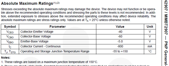

Derek, as a learning exercise you should get data sheet for 2907 and BC327 and compare specs and see why they would be compatible. Then in the future you would be able to find a substitute on your own :)
What the heck, here is snippits from the data sheets.
