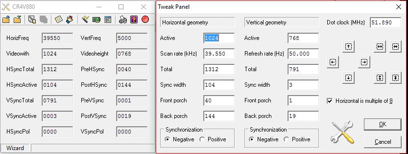

Hi, just wanted to give an update:
Yesterday I've received the connectors from TE an I'll try to build the "Special Device" interface in the next Days/Weeks.
I've also connected my old but very great DVD-Player (Momitsu DVD V880N) to the plasma panel via a DVI Cable (Dual Link 24+1). The cool thing about this DVD Player is --> I can enter custom DVI settings via the OSD to programm the internal EDID chip (inside the DVD-Player).
The panel shows a great picture using the following settings:
39550,1024,40,104,144,1312,0,50,768,1,3,19,791,0,51889600
