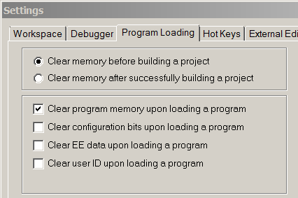

Ok, I can't seem to get the Pickit2 (V2.61) to stop overwriting the EEPROM in a 16F886. Even whn I deselect it the internal EEPROM is rewritten by the hex code EPROM (0x2100 allocation) .
I have CPD as off and CP as on:

You have to de select it on the programmer!
Pickit 2 and 3 have a "preserve eeprom" check window and it can stop any data being overwritten... If you use MPLAB then it will always clear the eeprom ( fills it with 0xff )
By "MPLAB," I assume you mean ICD3. Are you sure ICD3 erases eeprom? Using MPLAB IDE 8.92, one has a choice for retaining it, which is the same option screen I get for PicKits:

He mentions pickit2 but not the IDE so I assume pickit2 ( older ) so possibly MPLAB 8.xx
No MPLAB. Just a load hex and flash, I did deselect the EEPROM with the PICKIT2. It still overwrites.
It does...I am really not sure why it appears unreliable.
I am usung the standalone PK2 s'ware.
EDIT
It seems that if I deselect the EEPROM and try to reflash the hex autoload sequence of the PK2 renables the EEPROM writes.
I must load the hex, then deselect the EEPROM, then flash to get it right.
