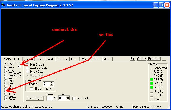

Nope he has it set wrong for what he is receiving Realterm has so many setting it wold that a week to learn how to use it. You can have the ground off but most times it will not write
try this
Set the pic to use two stop bits and it will sync up better.
Edit, and you definitely need the ground connecting. If it works without then it's connected via your Pickit2 or some other way.
