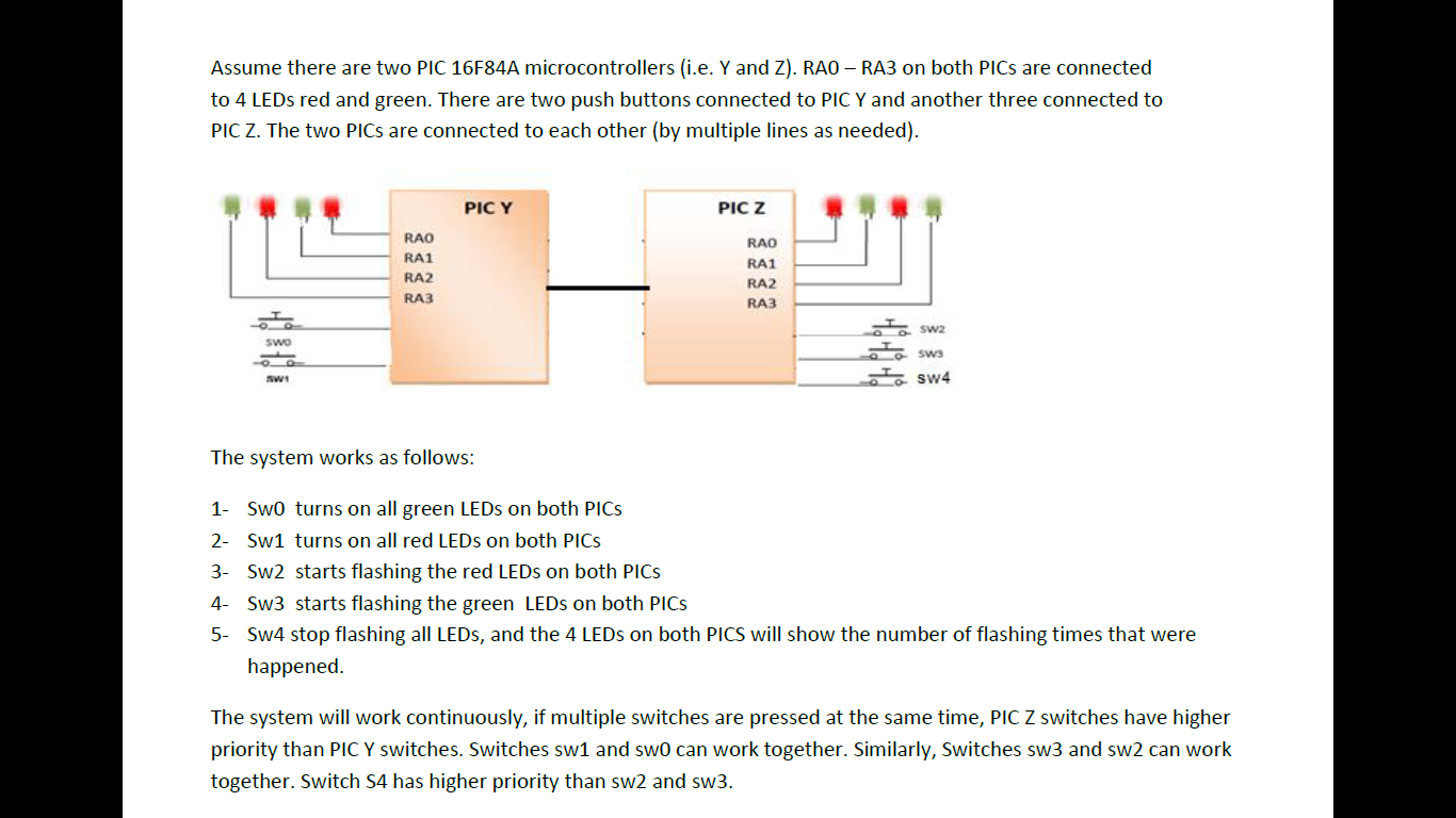

    How can I connect these LEDs and switches to PIC 16F84A ? I need to have PIC to PIC communication and the programing has to be in assembly using (MPLAB.) and then use(( proteus)) Screenshot (81).png

    I would suggest strating by writing the software to create a software UART ast the PIC17F84A does not have a hardwate UART. (You will probably find may examples of this on the web.) You can then use two pins on each PIC to communicate between the PICs I would decide to use one as master and the other as a slave. (The master would make all of the decisions. Based on the 5 switches.) As you have 8 data bits available you can use 4 to control the LEDs and either 2 or 3 bits (Depending on which one is master.) to send the state of the switches. I have just realised that you are allowed to use multiple lines to communicate so if Z was the master you could do it with 6 lines of the B port. In fact if you use one line per switch from PIC Y then the output of the switches could just be linked beteen the pics rather then using another two ports.

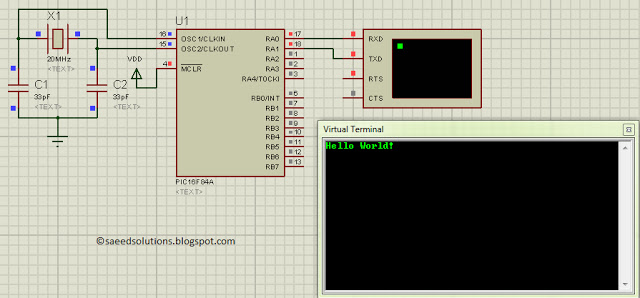

    Here's one that was written for 16F84A and simulates on proteus. Unfortunately, it was written in HiTech C. The theory is well explained and I tried it out on proteus and it works.
    May be the OP can treat the communication part as a black box first and concentrate on the switch and LED algorithm first. Once working then convert the C to ASM.
    http://saeedsolutions.blogspot.my/2012/10/pic16f84a-software-uart-bit-banging.html

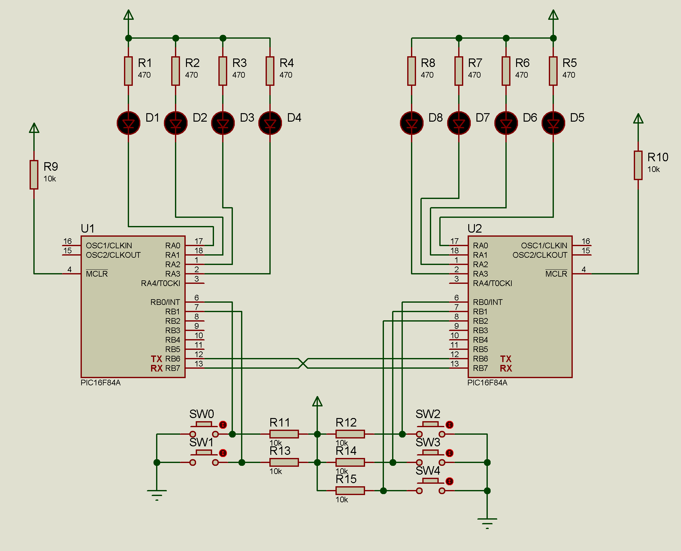

    Your hardware simulation in proteus would look something like below. I left out the oscillator part and I am not sure if RB6/7 is suitable for the soft uart. Please check the datasheet to confirm.
    F84 PIC-PIC COMMUNICATION.PNG Allen
    • Like Like x 2
