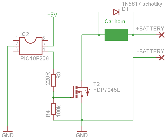

I have this 12V car horn I would like to drive using a PIC. I have made a simple circuit using an external 12V battery for the car horn supply. I'm using a MOSFET for driving the horn. But when the PIC turns on the MOSFET, the horn just makes a small "click" and the PIC resets. If I disconnect the MOSFET gate from the PIC pin and activates the MOSFET manually by connecting the gate to VDD through the 220R resistor, the horn sounds but the PIC still resets (I use a LED from another PIC pin to see if my PIC program starts over).
I suspect the inductive back EMF or similar from the horn is causing the reset. I just don't know how to avoid this. I have tried placing some schottky diodes, but this didn't help, maybe I didn't place them correctly?
The car horn is a solenoid and when current runs through, it pulls on the sound membrane. This pull also disconnects internal contacts inside the horn and the solenoid is disconnected from the supply. The sound membrane then pulls back and connects the solenoid again, repeating the process. You probably know this principle and there is maybe even a name for it that I don't know of ;-)
Oh, I forgot to mention that the 5V to the PIC is from another 5V battery not related to the 12V battery.
The easy solution would of course be to use a relay, but they get pretty big if they should be able to handle 5V for the coil and 3-4 amps for the horn.

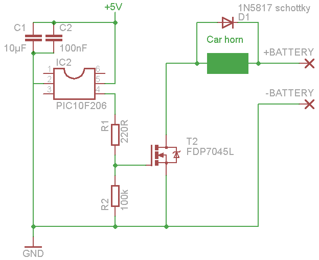

I actually have a 10µF cap between GND and +5V, just forgot to put it in the schematic.

Tie both grounds to the same spot(lug). Use short wires to connect,particularly on the grounds. Put a spike diode(5volt zener) with cathode to pin 4 and anode to ground.
BeerBelly, why do you assume a spike diode is needed on pin 4? If I disconnect pin 4 and connect R3 to VDD, the MOSFET turn on and the PIC still resets but ONLY when it's the horn that's connected, it does not reset if I replace the horn with a 12V headlight bulb.

This circuit now works on breadboard with short wires. The 10µF is an electrolytic capacitor and the 100nF is a polyester capacitor. I don't know, this doesn't seem different from what I started with, except the 100nF but it even works without it. Damn I hate this :confused: I'm sure the circuit won't work tomorrow :p
Are you telling me the only thing in common between the PIC and the horn is the ground?
My thought was possibly that the capacitive coupling between the source/gate was sending a spike to pin 4.
Yes, and I don't see how the PIC can be affected then, but it does somehow. Can a spike from the horn be so powerful it induces another spike in nearby wires?

You may find that swapping the polyester for ceramic will fix the problem. Decoupling is one of the main causes of problems on this forum.
