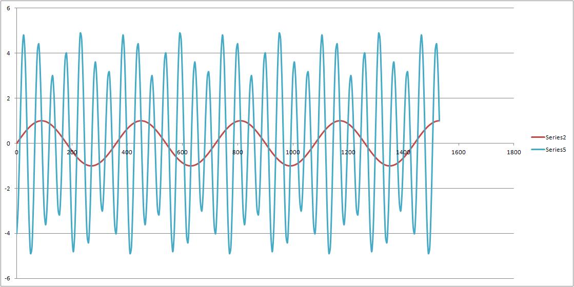

Just draw it out on paper, or on the VDU, like this:
I used Microsoft Excel.
The X axis is t
The red trace is Sin(t)
The greeny blue trace is Sin(5t) - 4.Cos(7t)
Have a look, count the peaks and troughs, find the period.
