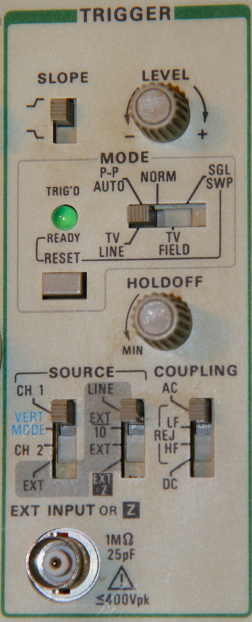

Billy, let's look at the attached image. SOURCE is used to determine the trigger source.
Now what do you see for SOURCE? For this particular scope I see CH1 (Trig off CH1 signal), Vert Mode (Trig of channel being displayed in vertical mode), CH2 (Trig off CH2 signal) and finally EXT for an external trigger signal. Note the shaded gray area for external which now includes LINE where the trigger source is the line frequency the scope is powered from, EXT / 10 where the external trigger signal input to BNC connector level is divided by 10, EXT where the external trigger signal into the BNC connector is used, and EXT Z which we won't get into but Z is the Z axis or intensity on the CRT. That is it for source.
Now if the scope is plugged into 60 Hz and we select EXTERNAL and LINE then our trigger signal is now 60 Hz. The scope will indeed trigger, however, there is no way you will obtain a stable display with a 400 Hz. signal displayed. You will have triggering but.... NO SYNCHRONIZATION. A 60 HZ trigger signal will trigger (with sync) a 60 Hz waveform or multiple of 60 like 120 or 240 or 480 HZ. The opposite is also true. Plug the scope into 400 Hz. power and choose a line source the scope will trigger but you will not be able to synch for example a 60 Hz signal. You could synch 400, 800 1.6 KHz and so forth.

Yes kinda.
My O-scope is plugged into 120vac 60hz.
My test fixture is plugged into 115vac 400hz
all the outputs signals of the test fixture are sync to 400hz not 60hz
how do I trigger and sync the scope to the test fixtures output signals?
A. Trigger using External trigger using 400 Hz. We have been over this. I don't have your scope sitting here so I don't know your options on your scope.
B. Trigger off the signal you are looking at. For example choose CH1 for the source and probe around looking at your signal on CH1. Using the above example SOURCE = CH1, MODE = P-P AUTO, SLOPE = + and LEVEL about mid range for starters.
There are options so pick one.
Yes True, but why no synchronization? because the O-scope horizontal is at 60hz so it can find a start point? why can't it obtain a stable display? is it because the O-scopes horizontal beam is defaulted at 60hz right? so when you apply a 400hz SOURCE this changes the O-scopes horizontal beam to 400hz not 60hz right?

my question is why can't u sync 60hz with 400hz?
Because 400 is not a multiple of 60.
Or, to use another non-electical example.
Q- Why does New Years Day fall on a different day of the week each year?
A- Because 365 is not a multiple of 7
You can't sync two frequencies unless they are exact multiples of each other. And why are you trying to do that anyway?
If you want to look at a 400Hz signal on Channel 1, just set your trigger source to be Channel 1. NOT LINE!!!
