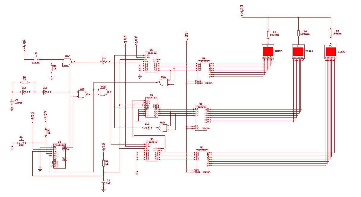

Operation of 3-minutes Digital Counter
Wjs
When I simulation this only one display working.
What goes wrong or the gate i used wrong.

please download and see the function table of 74LS247 and the note 3 below the tables. People believe that unused pin is High, but need not always be.
Hence the condition needed sappers to be RBO pin to be pulled UP . You might use 1K resistor for that.

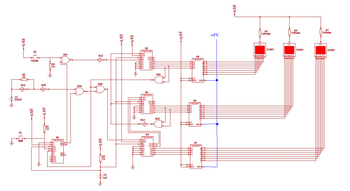

Fine Ian Rogers,
for some reason the OP did get only 1 digit.
i suggested him to add pull up on 74LS247 "rbo' pin.
the truth table shows like that and He need not leave them open, i suppose.

I tried but still same only one display is counting another two display not counting. are the gate issues ?
Can you perform Lamp Test(LT) checking how to do from the datasheet for the respective digits that refused to glow?
possibilities are that displays either faulty or model changed , unless the number tallies. you could sawap the LS247 chips one by one to the working display to check their performance.
